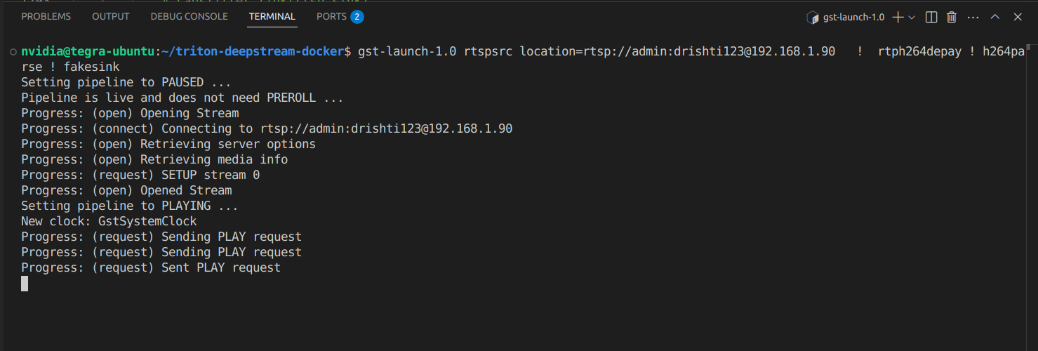

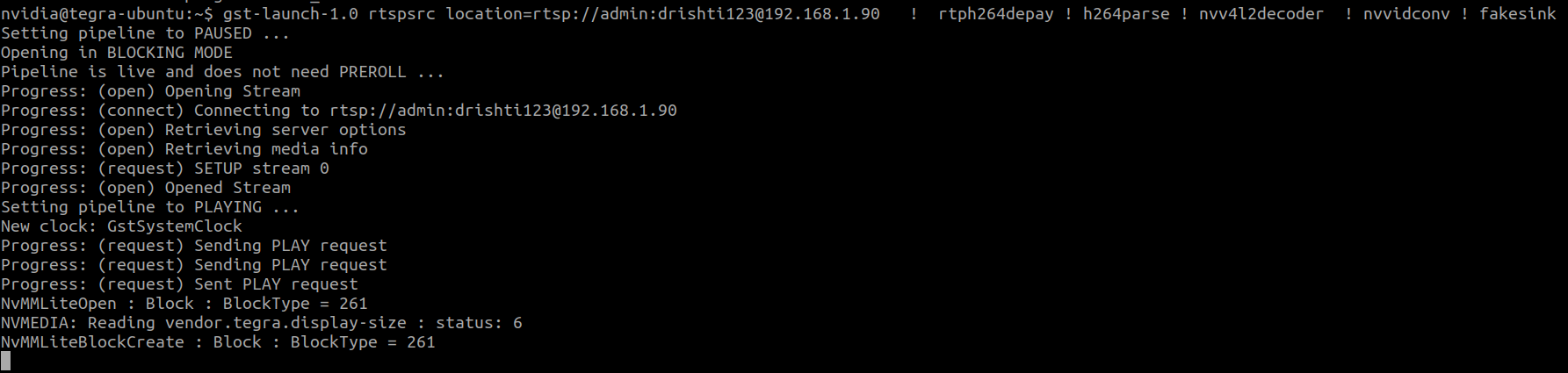

I was facing issues with avdec_h264 so I changed the pipeline to: gst-launch-1.0 rtspsrc location=<your_rtsp_src> ! rtph264depay ! h264parse ! nvv4l2decoder ! nvvidconv ! fakesink
Below the output i got,the command got stuck after that line.
This plugin cannot rule out whether the issue is related with the NV Gstreamer plugin or with the native Gstreamer plugin. Could you just run the pipeline below?
gst-launch-1.0 rtspsrc location=<your_rtsp_src>   !  rtph264depay ! h264parse ! fakesink
I have added the screenshot:

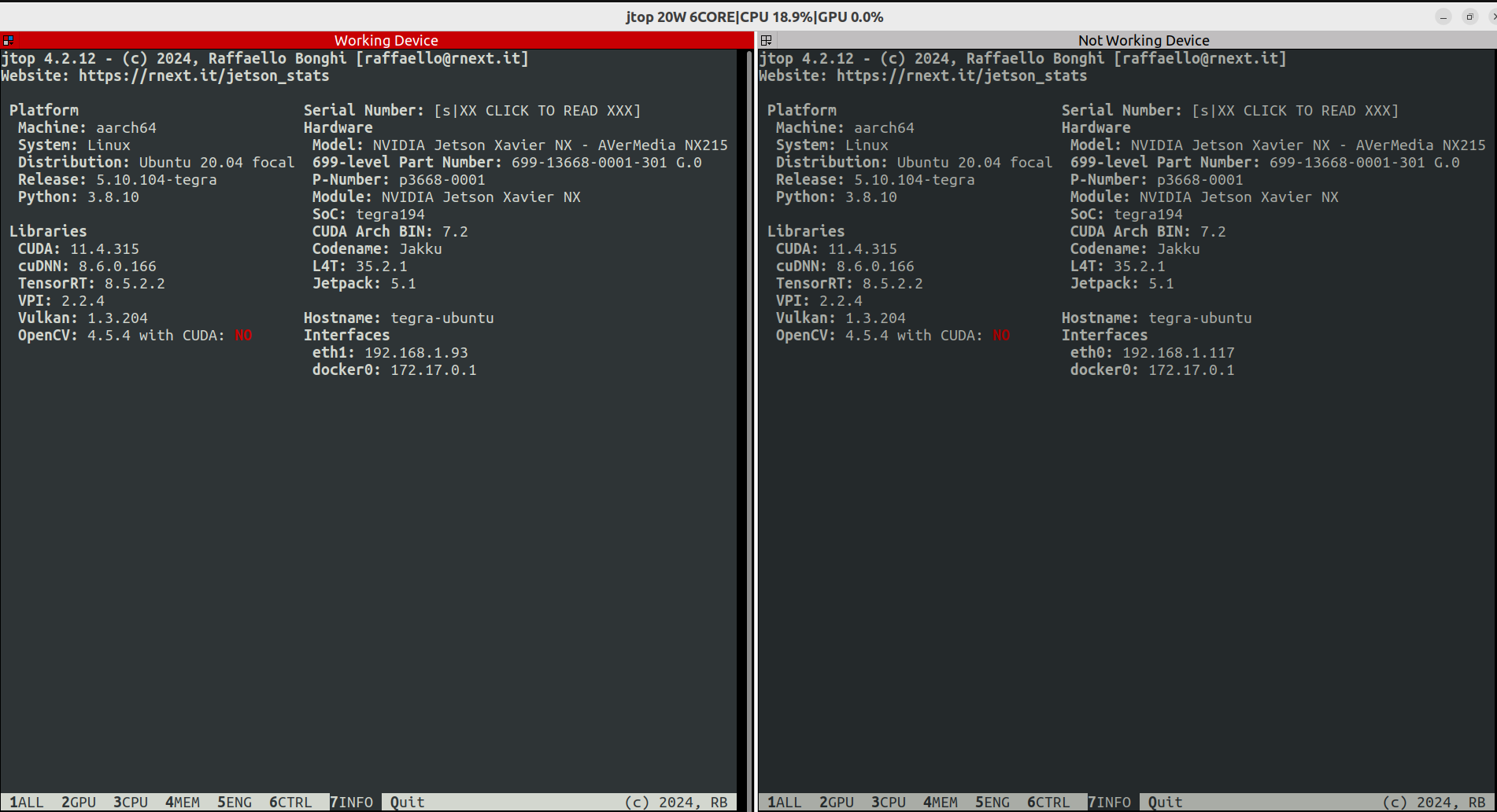

I am running the same pipeline on other jetson which have the specs, the pipeline is working fine on those its just this specific jetson that has been a problem to setup. So, I am sure that the RTSP stream is working as intended, I tried running the same rtsp stream with the current pipeline into another jetson where I didn’t faced any similar issues. I want to determine if this is due to any hardware components or a software issue.
P.S: I have already flashed the jetson once and still facing the problem.
Are the Jetpack and DeepStream versions of these two boards the same? What is the specific model of the other board?
I have attached a screenshot where left one is from the jetson where the pipeline is working, and the right one the jetson where the pipeline is not working.
This is weird. It seems that the model of your boards are exactly the same.
So could you attach the Jetpack version and DeepStream verison by the commands below?
