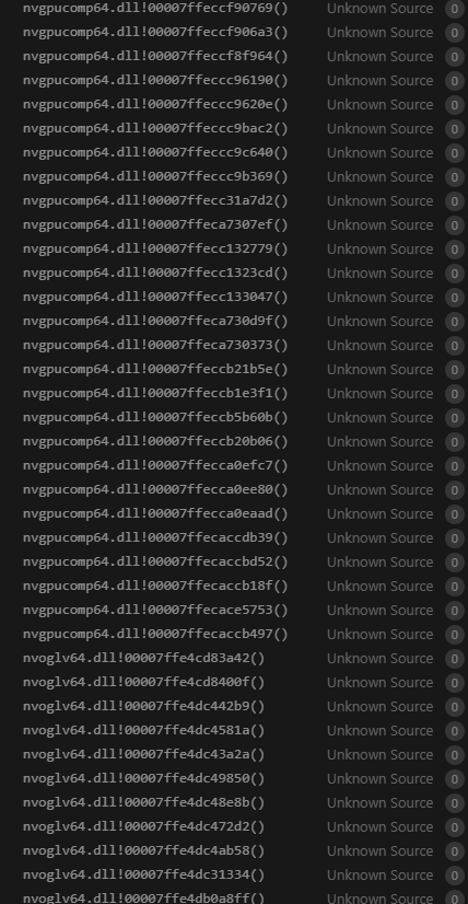

When I run it on RTX 5070 Ti sometimes it runs producing invalid values but most of the time it crashes and I get error:
Exception thrown at 0x00007FFECCF90769 (nvgpucomp64.dll) in app.exe: 0xC0000005: Access violation writing location 0x000002B5D418BDD4.
When it does not crash and produces wrong output only first image channel is affected (one that sm_vis is written to). I menaged to run app under NSight Graphics and when it does not crash second channel (one with warp_vis) is all filled with zeros while first has values ranging from 0 to 1 but when I change imageStore(image, ivec2(x, y), vec4(sm_vis, warp_vis, 0, 0)); to imageStore(image, ivec2(x, y), vec4(warp_vis, sm_vis, 0, 0)); only second channel has correct values (greenish output) and first one is full with zeros.
When i only use 1 channel app never crashes and produces correct result (either visualizing warps or SMs).
Backtrace shows that it comes from vkCreateComputePipelines and after that call stack trace looks like:
Same shader works perfectly fine on RTX3060.
