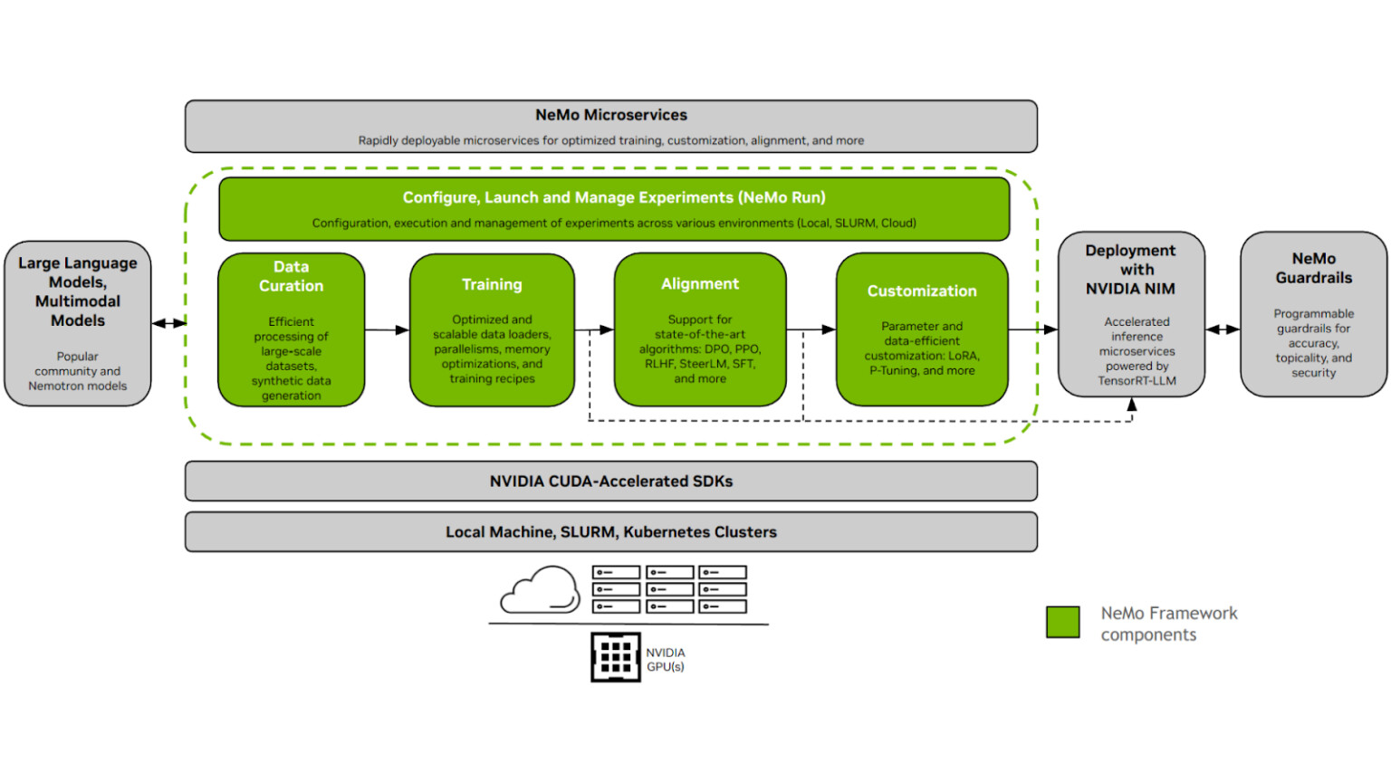

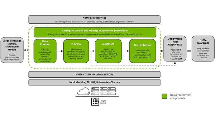

Customize Gemma for your data with the open NVIDIA NeMo Framework
Developers can use the Gemma 3n models from Hugging Face with the open source NVIDIA NeMo Framework. It provides a comprehensive framework for post-training Llama models to achieve higher accuracy, specifically through fine-tuning with enterprise-specific data. The workflow within NeMo is designed to be end-to-end, covering data preparation, efficient fine-tuning, and model evaluation.
Figure 1. NeMo Framework provides end-to-end support for large language models and multimodal models.
The workflow includes:
  • Data curation (NeMo Curator): Curator prepares high-quality datasets for either pretraining or fine-tuning by offering tools to extract, filter, and deduplicate large volumes of structured and unstructured data. It ensures the quality of the input data for the model.
  • Fine-tuning (NeMo): Once the data is curated, NeMo enables efficient fine-tuning of Llama models. It supports various techniques to optimize this process, including LoRA (Low-Rank Adaptation), PEFT (Parameter-Efficient Fine-Tuning), and full parameter tuning for comprehensive customization.
  • Model evaluation (NeMo Evaluator): After fine-tuning, NeMo Evaluator is used to assess the performance of the adapted models using custom tests and benchmarking.
