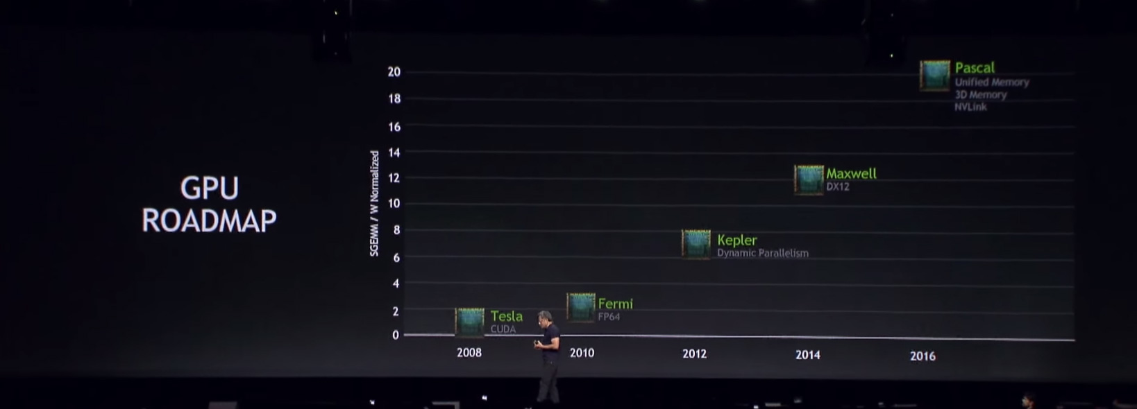

Another motivation for getting Maxwells is that nVidia will likely soon be releasing newer versions of these cards with substantially more SM’s on board. You’ll feel substantially less guilty about upgrading if only spending 140 a piece now. Plus you get to write and optimize your code for the newest architecture, which is why I’m using this for development.
Actually, for each stream you add, total bandwidth probably wouldn’t be much effected as each kernel would only be pulling the proportion of data for the compute resources it has allocated. So never mind that comment about only two streams.

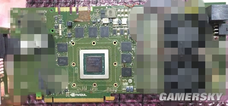

Thanks for the advice. Rumor web sites mention Q4 of this year, and also that GM1xx will be dropped. Perhaps there are problems with it? Or maybe they found a way to improve the architecture.
Latest rumors I’m seeing are that the GM204 will be ready in Oct/Nov time frame. It should basically be a GM107 chip with 3-4 times as many cores and maybe some additional L2 cache. It will be a 28nm chip (same as Kepler). Looks like nVidia will be be skipping the 20nm process and going right to 16nm in 2015. With those specs it should hit 4.8 - 6.4 Gflops in sgemm.
Sorry, Tflops not Gflops.
