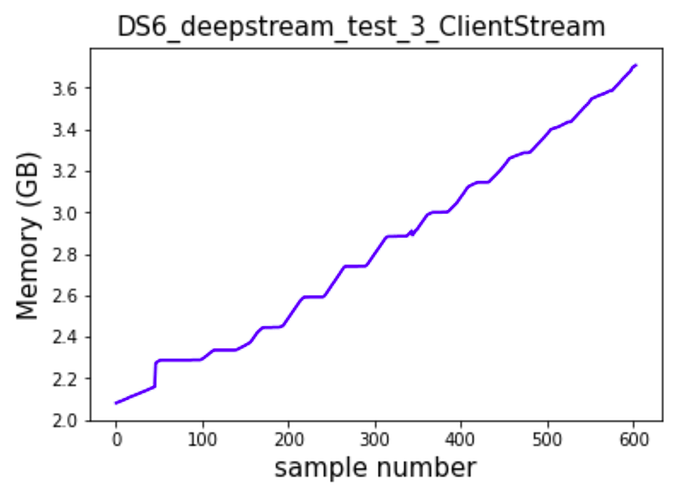

So I tried to run inferece on a clients RTSP stream (3 RTSP sources) using the python deepstream-test3. The only change i did was replacing nveglglessink with fakesink. Everything worked fine but then I checked for memory usage using the following command
docker stats <Deepstream-container-name>
I observed that the memory utilzation kept on increasing.
Upon taking logs of the memory utilization i was able to plot the below graph
Here every sample was taken every 5 seconds.
This can be reproduced with deepstream-test3 python app

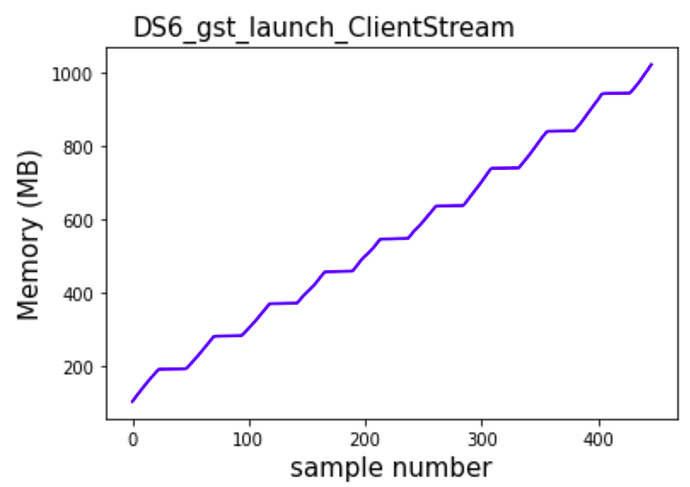

To ensure that this was not an issue related to the model taking up space over time or something to do with python failing in its garbage collection i tried implementing a simple pipeline using the gst-launch-1.0
gst-launch-1.0 \
uridecodebin uri=<RTSP_source1>! nvvideoconvert nvbuf-memory-type=3 ! "video/x-raw(memory:NVMM),format=RGBA" ! m.sink_0 \
uridecodebin uri=<RTSP_source2> ! nvvideoconvert nvbuf-memory-type=3 ! "video/x-raw(memory:NVMM),format=RGBA" ! m.sink_1 \
uridecodebin uri=<RTSP_source3> ! nvvideoconvert nvbuf-memory-type=3 ! "video/x-raw(memory:NVMM),format=RGBA" ! m.sink_2 \
nvstreammux name=m nvbuf-memory-type=3 width=1280 height=720 batch-size=3 sync-inputs=1 live-source=1 batched-push-timeout=100000 ! queue ! fakesink sync=0
Here was the observation
so clearly there is no issue with the model or python mismanaging the memory.

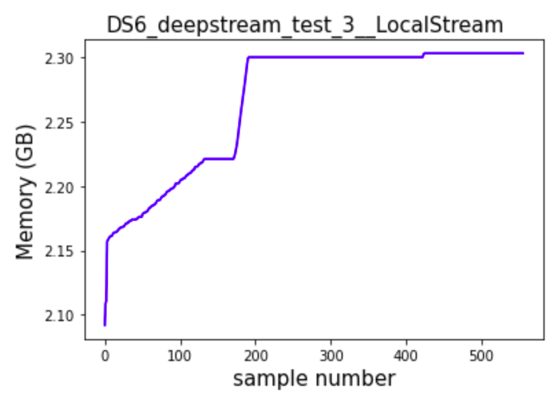

Further Observation :
I later even tried seeing how the memory increases when running inference on an RTSP source from the local system using ffmpeg (called it synthetic test) . these were the observations
as can bee seen here there is signicficantly less memory leak compared to how it performed from the clients RTSP source.
Although there still is a small amount of memory leak.
