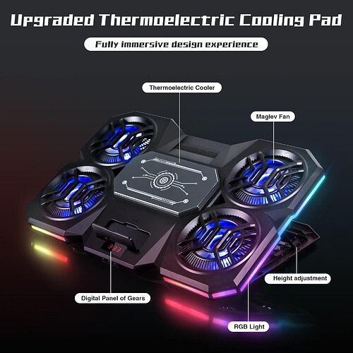

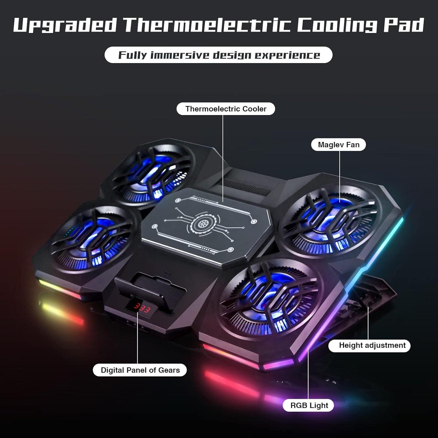

This is what I currently have but I’m replacing my TARGUS Laptop fan with the QUICARD
Please be VERY MINDFUL with the TECs they DO make ICE, that’s why I have them below the vents and not touching the Sparks.
That actually exists? :o Wow, I feel so .. But now that you tested, yea, it would be bad get that condensation formed inside of DGX. Thanks for update.
If you’re asking about the TEC from the previous thread that’s the FS12-45 Tablet cooler and is ~$29
The QUICARD I’m replacing the TARGUS with is $69.99
The Acrylic Stand and TEC is $39.99
The actual “rack” idea with proper fans and TECs was over $4K and was not worth the build for minimal impact given how insulated the Sparks are.
https://www.aliexpress.us/item/3256809021967972.html?gatewayAdapt=glo2usa4itemAdapt
With the laptop fan base with built in TECs, propped up on the open acrylic stands and ensuring the vents are not obstructed with the mini TECs below, the units have been cold on standby, and cool running AI Workbench. I haven’t run anything heavy or overnight yet. So far this setup looks promising, or at least supportive.

Re: condensation
I have both Sparks on 1.5 in high acrylic mounts.The Sparks don’t touch the TECs, they also don’t touch the fans or the TEC built in the laptop cooling pad. The external TECs (the two little ones on both sides of the laptop cooling pad digital panel) are positioned away from the Spark body.
I never placed the TECs on the Spark given the high temp delta. However, although I had a similar set up (Sparks on acrylic mounts) with the Targus the little TECs did create ice below them when they were sitting directly on the Targus cooling pad.
My old Targus has 2 Fans, the QUICARD has 4, the Targus was pushing more air on an equally open body, the QUICARD has 4 localized fans and the TEC in the middle doesn’t get that cold.
Depending on how we progress over the next week or two I may add this side fan from the back for ‘emotional support’.
