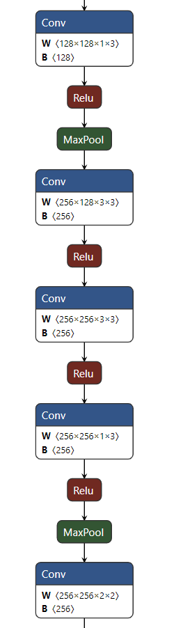

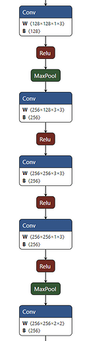

I have a simple conv net work :
the input shape is (1, 32, -1, 1), which means the input image width is dynamic.
I set dynamic shape profile:
min shape = ‘{“image_placeholder”: [1,32,16,1]}’
opt shape = ‘{“image_placeholder”: [1,32,128,1]}’
max shape= ‘{“image_placeholder”: [1,32,2048,1]}’
When I infer image with shape [1,32,128,1] it’s ok, but when I infer image with shape (1, 32, 170, 1), it give error: [convolutionRunner.cpp::executeConv::458] Error Code 1: Cudnn (CUDNN_STATUS_BAD_PARAM).
Moreover, the error only happens when I use fp32 mode, it’s ok for fp16 mode.
I get this error when I use TensorRT 8, for TensorRT7, I did not get this error.
Can you give any solutions? Thanks.
