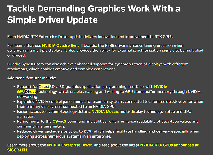

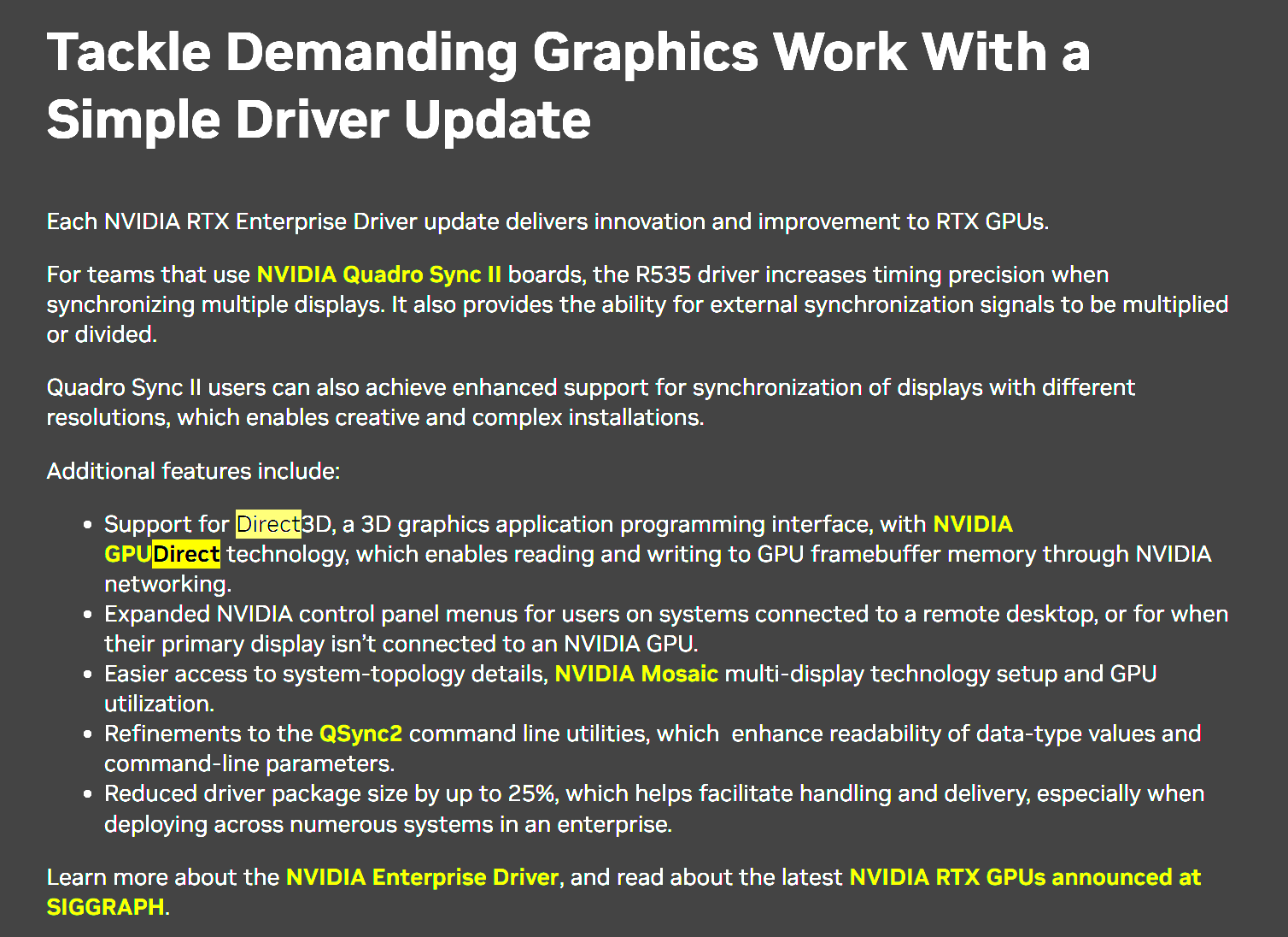

And on Download website for Enterprise GPU Driver you mention that your Enterprise driver has Windows support for GPUDirect

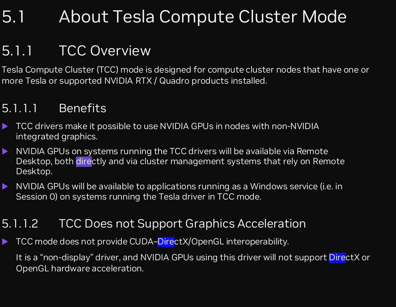

Then in release notes you mention TCC:
And that TCC does not support DirectX or OpenGL and it is, in industry we say “headless” driver rather that “non-display” driver. So basically I would not maybe need cuFile and I would need to create that Windows service you mention you already have and that Windows service would send CUDA API calls to Ubuntu in WSL2 using WSLg (like passthrough or direct api).
