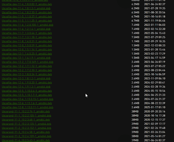

At least CUDA 12.6 on linux includes cuFile. There is $CUDA_HOME/include/cufile.h and the corresponding library files in $CUDA_HOME/lib64/libcufile*.so
cuFile is part of GPU Direct Storage (GDS).
GDS requires linux.

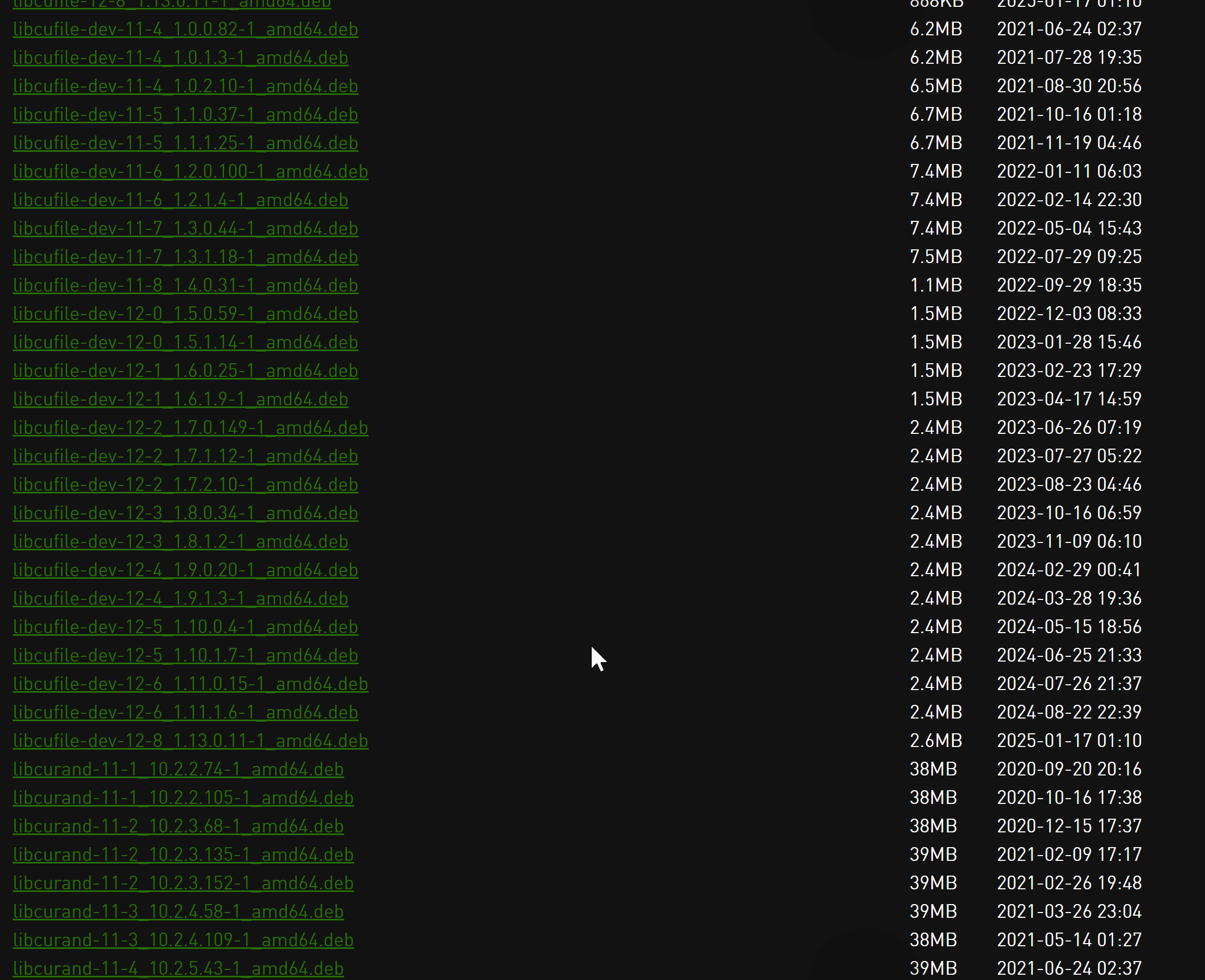

There is clear mention that cuFile is standalone independent user library and even mention of future plan that it should be merged to cuda.h. There is no mention on GDS and same information is spread across 3 web pages on your domain.
Here you can see libcufile*.deb and no GDS - that is separate. So no mention in DOCS, no connection in DEPLOY.
Please I know I came here angry, but now I’m trying to find some solution. I will propose solution at the end of this post, but first we should analyze what is happening, so we have better understanding of context and potential risks of escalation. We should deescalate. So please, I understand you need to represent stakeholders and protect their privileges, just this was unlucky example. It seems to be more business oriented approach rather than scientific analysis.
Magnum IO was the first implementation, but recently your company evolve into new proposals in terms of standalone GPUDirect functionality which targets different market than Magnum IO.
In current deployment, cuFile.so is located at \usr\local\cuda-12.5\targets\x86_64-linux\lib
Therefore it is located under cuda-12.5 toolkit. There is no mention of Magnum IO and no connection with GDS. Further more cuFile license and changelogo nowhere mentions Magnum IO nor GDS, there is contact on cudatools team only:
libcufile (1.10.1.7-1) stable; urgency=low
  • Automatic Debian package build
– cudatools cudatools@nvidia.com Thu, 06 Jun 2024 10:53:01 +0000

Have you confirmed that cuFile does not use any Linux (e.g. driver or kernel) specific features? You mention libmount and libnuma as direct library dependencies, even libcuda could contain some linux-only features.
Even if it can be made to run on Windows, there is still all the testing effort and quality assurance stuff.

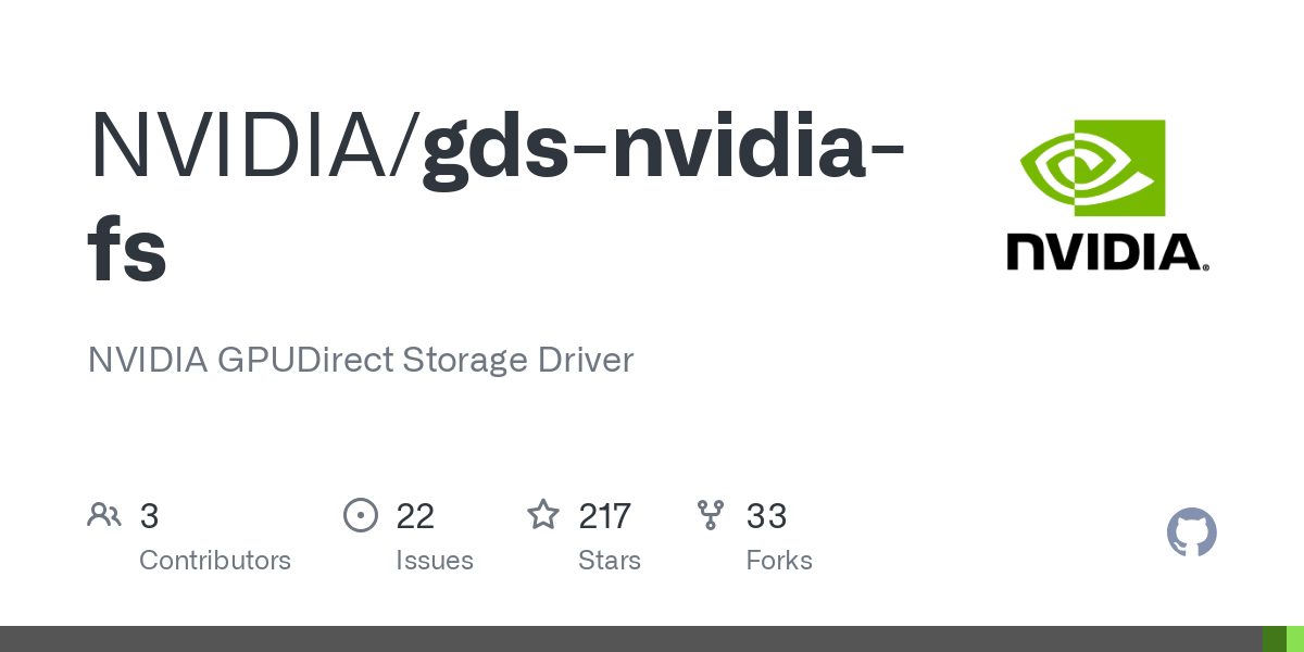

The Linux documentation mentions that you need to have the nvidia-fs.ko kernel module installed.
Libraries often have some extra ways to communicate with file systems and do not always need included libraries.
E.g. ioctl(2) - Linux manual page (not saying cuFile uses those).
If you still say that that module is not needed, then first try to get it to run on Linux without. The documentation says cuFile will go into a compatibility mode copying the data over the host side. But you want RDMA.
