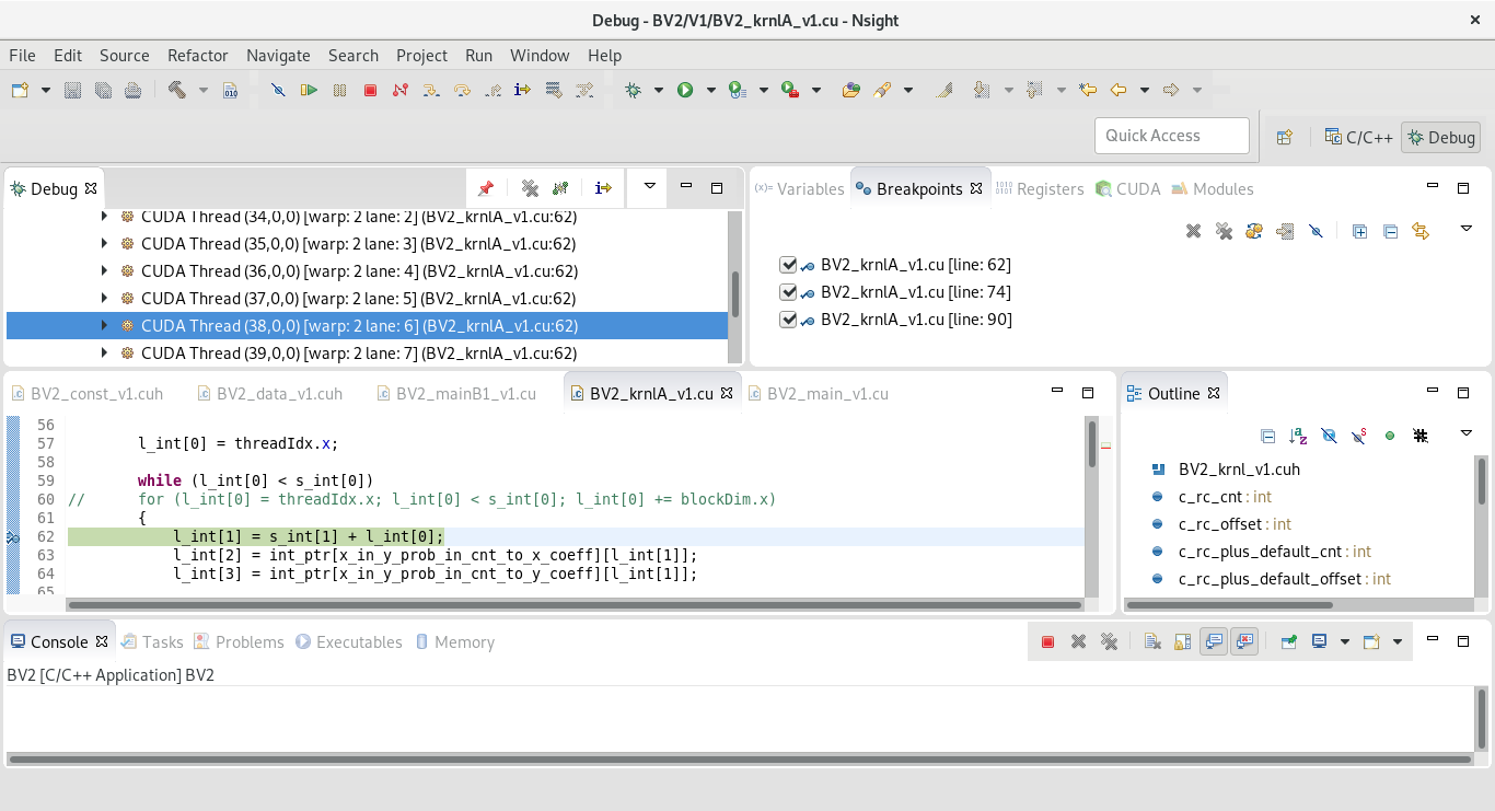

is the following for loop in a kernel valid?
for (l_int[0] = threadIdx.x; l_int[0] < s_int[0]; l_int[0] += blockDim.x)
s_int[0] is shared memory (int), and in this case the value is 36. blockDim.x = 256
threads with threadIdx.x > s_int[0] enter the loop too, and the debugger then show their threadIdx.x (actual threadIdx.x) smaller than s_int[0], while the debugger show their thread nr (debugger nr for thread(Idx.x) as > s_int[0];
this still occurs when i change the for to a while loop
while (l_int[0] < s_int[0])
l_int[0]+= blockDim.x;

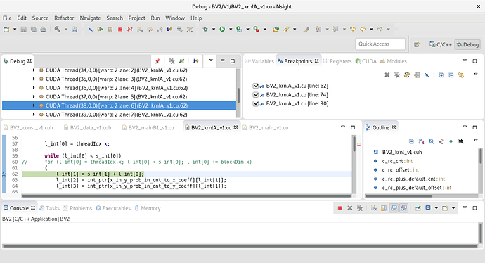

in the image, i have selected thread 38, which should not participate in the loop.
the debugger shows threadIdx.x as 32 when i place the mouse on it (see line 57).
again, s_int[0] shows as 36
l_int[0] is declared as: int l_int[6];

i am still pulling apart and debugging. at first i thought i wrote the kernel too complex. if i write a simple block, it works fine.
please see if you can reproduce the issue, if you dont mind. below the code. i tried to make the kernel as simple as possble.
you will/ should note that the first
works fine. threads outside/ over/ above the threshold (s_int[0]) jump the loop, as they should.
the 2nd for loop does not work as it should. the debugger shows threads greater than the threshold changing their threadIdx.x to the threshold, and they then enter the for loop.
