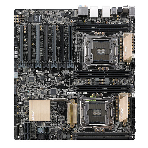

…yes, … but this is an ASUS D8 WS board full X16 support for 4 cards and 2 x E52690v4 CPU’s etc…

The D8 WS is an older board and the driver is likely not well tuned for that layout. Also, the specs I find says it runs at 8x PCIe with 4 cards installed.
… the D8 board I’m referring top above is the nice one :-) Z10PE-D8 WS full 4 way X16
https://www.asus.com/us/Motherboards/Z10PED8_WS/
