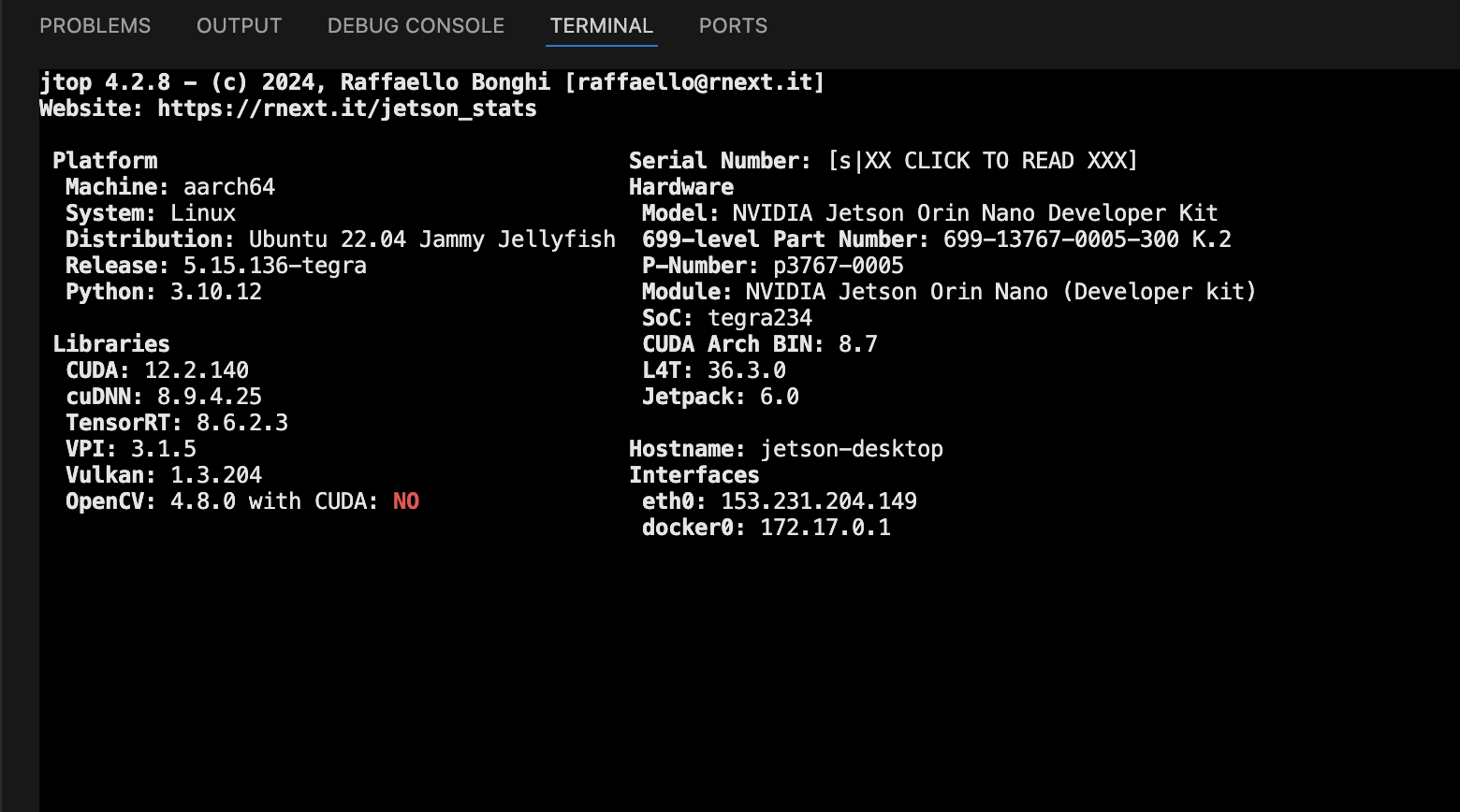

I was wondering how I could use my app in container, so I made the image with this Dockerfile :
# Use an image compatible with Jetson Orin Nano and L4T 36.3.0
FROM nvcr.io/nvidia/l4t-jetpack:r36.3.0
# Set the working directory
WORKDIR /app
# Update and upgrade the system packages
RUN apt-get -y update && apt-get -y upgrade && apt-get install -y libopenmpi-dev libopenblas-dev
# Install necessary packages
# RUN apt-get install -y libcanberra-gtk-module libgbm1 libatk-bridge2.0-0 libgconf-2-4
# RUN apt-get install -y libgtk-3-dev libgtk-3-0 libgirepository1.0-dev
RUN apt-get install -y gobject-introspection libcairo2-dev
# Install pip3
RUN apt-get install -y python3-pip
# Copy your application code into the container
COPY ./workspace/concrete_project /app
# Install meson
RUN pip3 install meson==1.4.0 ninja
# Install Python dependencies
COPY ./workspace/concrete_project/requirements.txt /app
RUN pip3 install -r /app/requirements.txt
RUN pip3 uninstall -y opencv-python
# Define the command to run your app
CMD ["python3", "main.py"]
then I made container by this command :
docker run --privileged -v /dev/video0:/dev/video0 --device=/dev/video0:/dev/video0 -v /lib/modules:/lib/modules --runtime nvidia -it --volume /tmp/argus_socket:/tmp/argus_socket -v /mnt/usb_storage:/mnt/usb_storage -v /tmp/.X11-unix/:/tmp/.X11-unix/ -e DISPLAY=$DISPLAY --name app concrete_observer:1.0.0-production
then I got this error:

File "/app/main.py", line 569, in <module>
detector("ZERO","C")
File "/app/main.py", line 107, in detector
cv2.namedWindow(window_title, cv2.WINDOW_NORMAL)
cv2.error: OpenCV(4.8.0) /home/ubuntu/opencv_build/opencv/modules/highgui/src/window_gtk.cpp:169: error: (-215:Assertion failed) image_widget && "GTK widget creation is failed. Ensure that there is no GTK2/GTK3 libraries conflict" in function 'cvImageWidgetNew'
