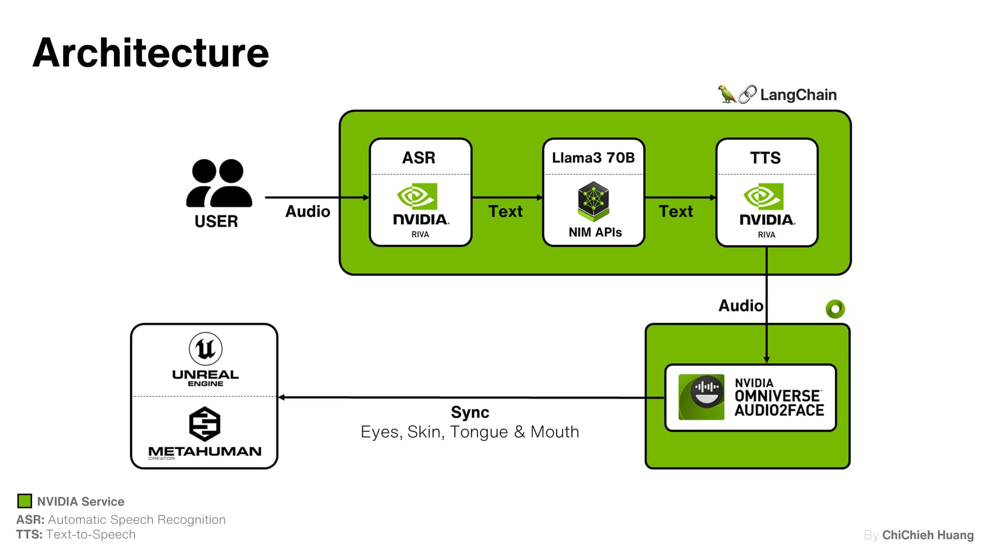

Architecture:
Features:
  • Speech Recognition: Converts user speech into text in real-time using NVIDIA RIVA ASR technology.
  • Language Processing: Leverages advanced LLM (such as llama3-70b-instruct) via NVIDIA NIM APIs for deep semantic understanding and response generation.
  • Text-to-Speech: Transforms generated text responses into natural-sounding speech using NVIDIA RIVA TTS.
  • Facial Animation: Generates realistic facial expressions and animations based on audio output using Audio2Face technology.
  • Unreal Engine Integration: Enhances virtual character expressiveness by real-time linking Audio2Face with Unreal Engine’s Metahuman.
  • LangChain Integration: Simplifies the integration of NVIDIA RIVA and NVIDIA NIM APIs, providing a seamless and efficient workflow for AI development.
