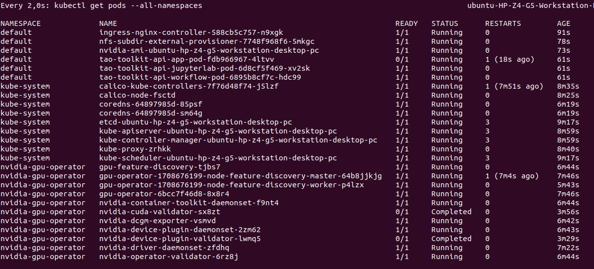

Command kubectl get pods --all-namespaces:
Executing command kubectl delete crd clusterpolicies.nvidia.com gives this log:
output.txt (167.2 KB)
With the TAO api installation stuck. The kubectl describe pod tao command gives this info:
kubect_describe.txt (4.9 KB)
with errors related to connection refused during the liveness checks.

The error of the tao-toolkit-api pod is due to liveness:
kubectl_describe_1.txt (4.8 KB)

Could you
$ kubectl logs -f tao-toolkit-api-app-pod-fdb966967-4ltvv
Also, can you share gpu-operator-values.yml ?

with TAO pod failing:
Could you run below and share the result? Thanks.
$ helm ls
$ helm upgrade --install --reset-values --cleanup-on-fail --create-namespace --namespace default --atomic --wait tao-toolkit-api https://helm.ngc.nvidia.com/nvidia/tao/charts/tao-toolkit-api-5.0.0.tgz --values /tmp/tao-toolkit-api-helm-values.yml --username='$oauthtoken' --password=ZXJhdWU5ZWluNG1uNHB2bWZldW51dm5mdWY6YzM1YWM2YjAtYmNmNC00N2QwLTk4ZGMtODA1ODBhM2FhNmUw --debug
