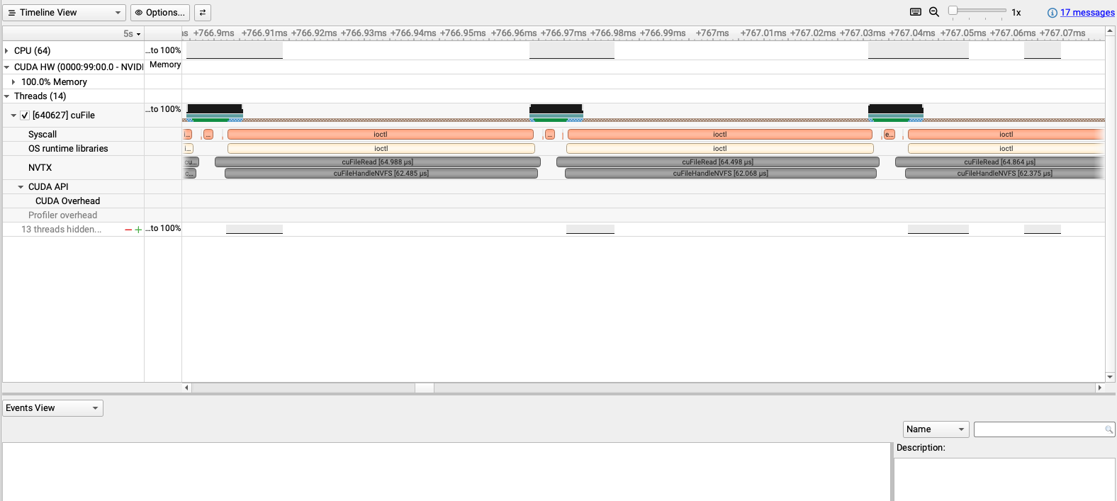

I have a few more questions when using Nsight Systems (2025.3.1) to profile my workload.
Sync (-x 0) Result:
