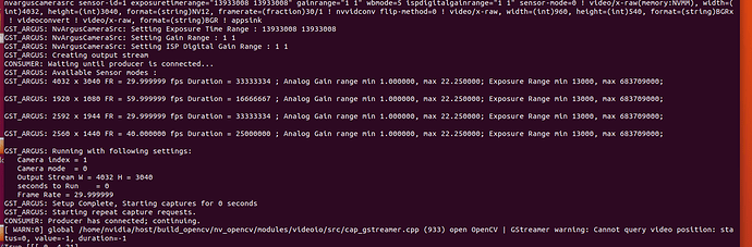

We’re very new to the Nvidia platform, and Gstreamer pipelines, We’re using two Uctronics Arducam B0279s in tandem to basically get a dual video of what we’re analyzing, but we seem to have a problem where in the video is being downscaled somehow. Essentially, we want to take these videos in tandem at 4k@30fps if possible, but 2k@40fps is also fine.
I tried here to attach the output when we ultimately run the code it looks like it’s being downscaled to 960x540, which is half of 1920x1080. It LOOKS LIKE it’s telling us that it’s runing in 4k@30fps, but that’s not what the output of the videos saved or the analysis code we are running separately are seeing. It looks like it’s being downscaled to both, and we’re getting very low resolution and in the saved videos very low FPS. What’s the best way to ensure we’re effectively controlling both of these factors?
Your command downscale to 960x540. Change it to what you want.
.... ! nvvidconv flip-method=0 ! video/x-raw, width=(int)960,height=(int)540, format=(string)BGRx ! .....

There’s are two part have the width/height parameter, first place to choose sensor output size second place configure the output size.
