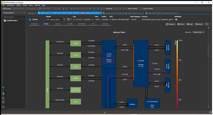

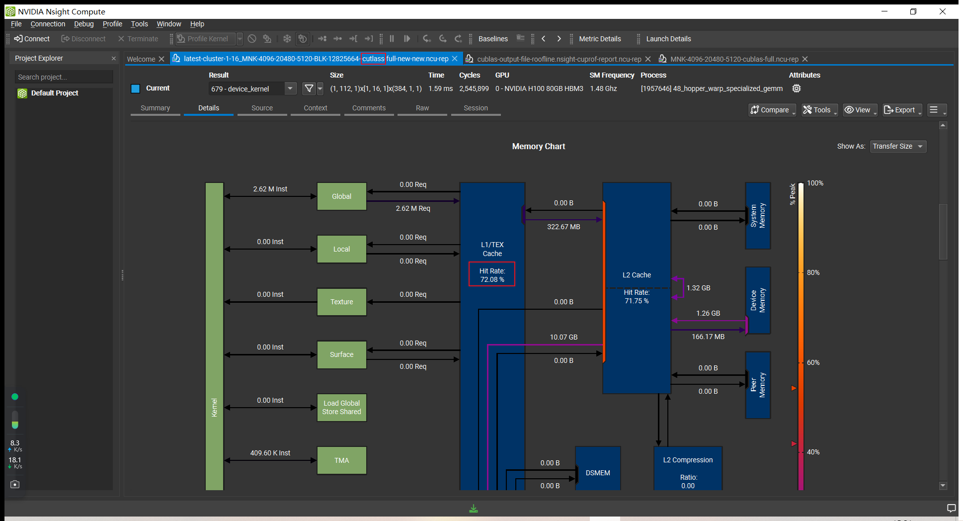

I noticed that in GEMM, we will only use SMEM to load A/B, and store C. Seldom will we use L1/TEX. Is there any classic situation we want to use L1?

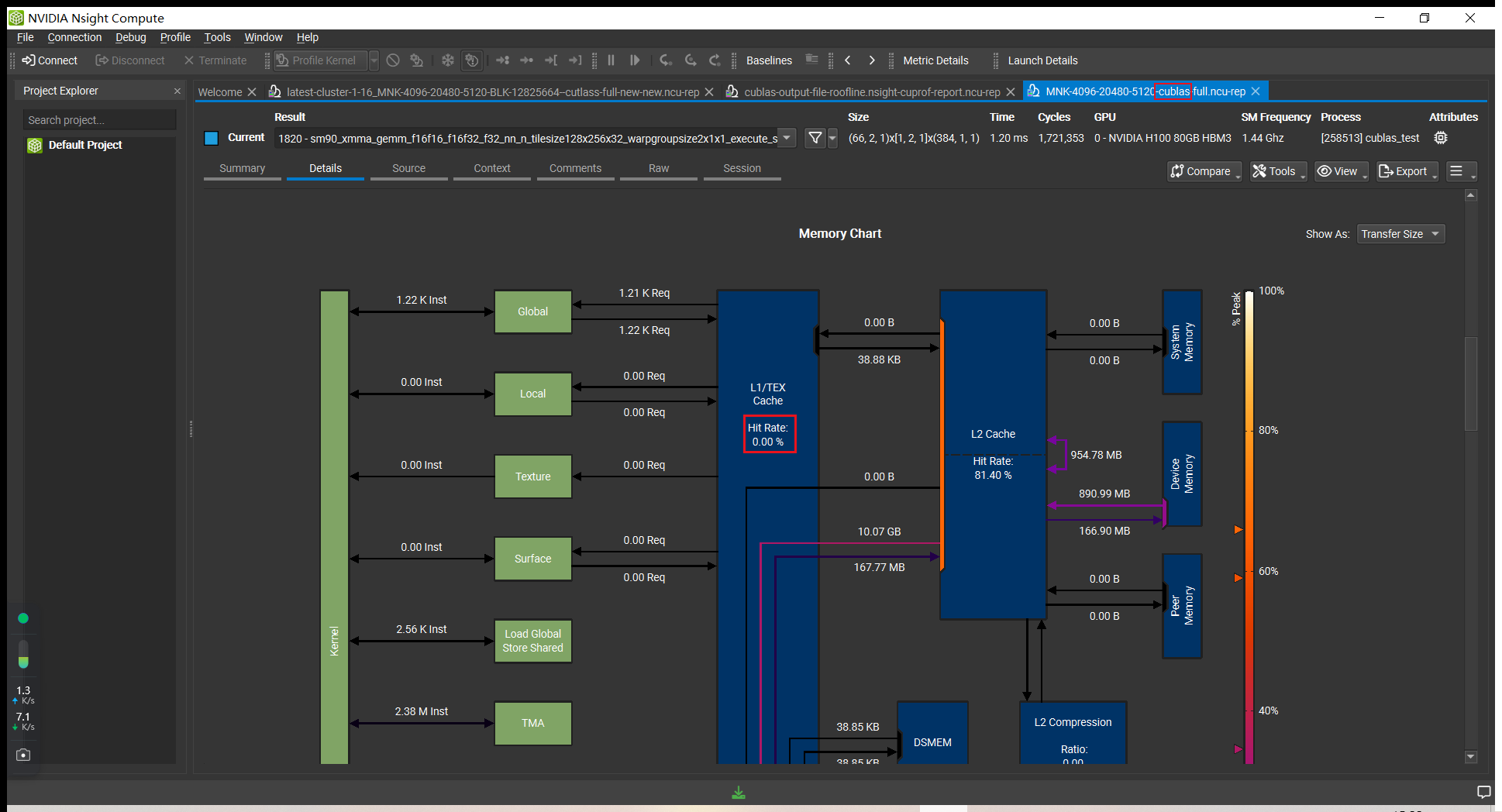

By the way, I noticed cutlass uses L1/TEX for GEMM on Hopper, but I do not understand how. Is this important? (But cublas does not)
cutlass
cublas

Using shared memory would not necessarily appear as L1 hit, you have to look at the tables below the graph in Compute Nsight to see the amount of shared memory stores and loads.
