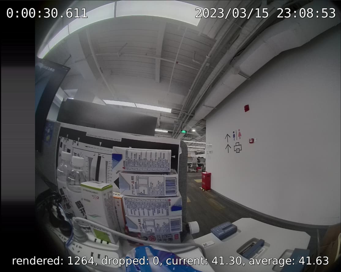

Why is the frame rate of v4l2 60fps, but gstreamer shows 41fps?
Hi all:
Device:
Orin NX
Soft Version:
jp5.1.2
Command:
gst-launch-1.0 -ev v4l2src device=/dev/video3 ! timeoverlay ! clockoverlay halignment=right valignment=top time-format=“%Y/%m/%d %H:%M:%S” ! video/x-raw, width=1920, height=1536 ! videoconvert ! fpsdisplaysink sync=false 2>&1

root@tegra:/home/robot# v4l2-ctl -d /dev/video3 --set-ctrl sensor_mode=1 --set-fmt-video=width=1920,height=1536 --stream-mmap
<<<<<<<<<<<<<<<<<<<<<<<<<<<<<<<<<<<<<<<<<<<<<<<<<<<<<<<<<<<<< 59.86 fps
<<<<<<<<<<<<<<<<<<<<<<<<<<<<<<<<<<<<<<<<<<<<<<<<<<<<<<<^C
root@tegra:/home/robot# gst-launch-1.0 -ev v4l2src device=/dev/video3 ! timeoverlay ! clockoverlay halignment=right valignment=top time-format="%Y/%m/%d %H:%M:%S" ! video/x-raw, width=1920, height=1536 ! videoconvert ! fpsdisplaysink sync=false  2>&1
DTS:
dts.txt (447.2 KB)

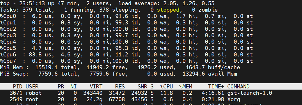

The CPU usage is not high either, so why do the displayed frame rates differ when the commands are different?

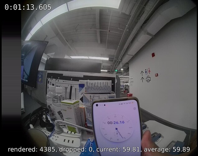

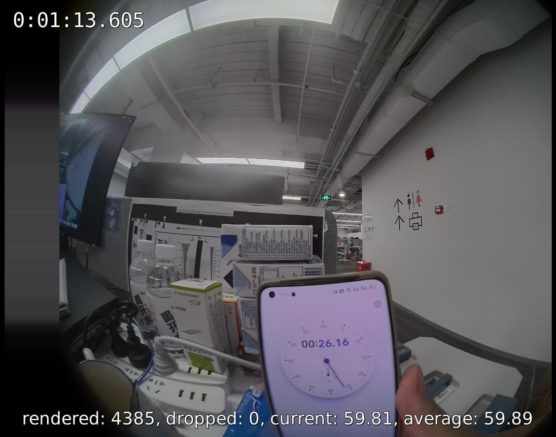

60fps:
gst-launch-1.0 -ev v4l2src device=/dev/video3 ! timeoverlay ! rawvideoparse format=4 width=1920 height=1536 ! videoconvert ! fpsdisplaysink video-sink=xvimagesink sync=false
52fps
gst-launch-1.0 -ev v4l2src device=/dev/video3 ! timeoverlay ! video/x-raw, width=1920, height=1536, framerate=60/1 ! videoconvert ! fpsdisplaysink sync=false 2>&1
41fps
gst-launch-1.0 -ev v4l2src device=/dev/video3 ! timeoverlay ! clockoverlay halignment=right valignment=top time-format=“%Y/%m/%d %H:%M:%S” ! video/x-raw, width=1920, height=1536, framerate=60/1 ! videoconvert ! fpsdisplaysink sync=false 2>&1
