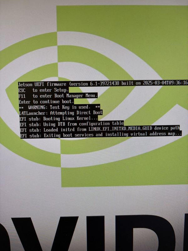

Hi, I flashed my AGX Xavier using Ubuntu 20.04 with JetPack 5.1.5 (L4T R35.6.1).
I followed the steps below to generate keys and fuse the device:

Then I flashed the board with signed binaries:
sudo ./tools/kernel_flash/l4t_initrd_flash.sh --no-flash \
-u rsa_priv.pem -v sbk.key jetson-xavier mmcblk0p1
frm_no_flash.log (248.3 KB)
sudo ./tools/kernel_flash/l4t_initrd_flash.sh --flash-only \
frm_flash_only.log (63.7 KB)
However, after flashing is complete, the Xavier doesn’t boot (no UART or HDMI output).
What step might I have missed?
