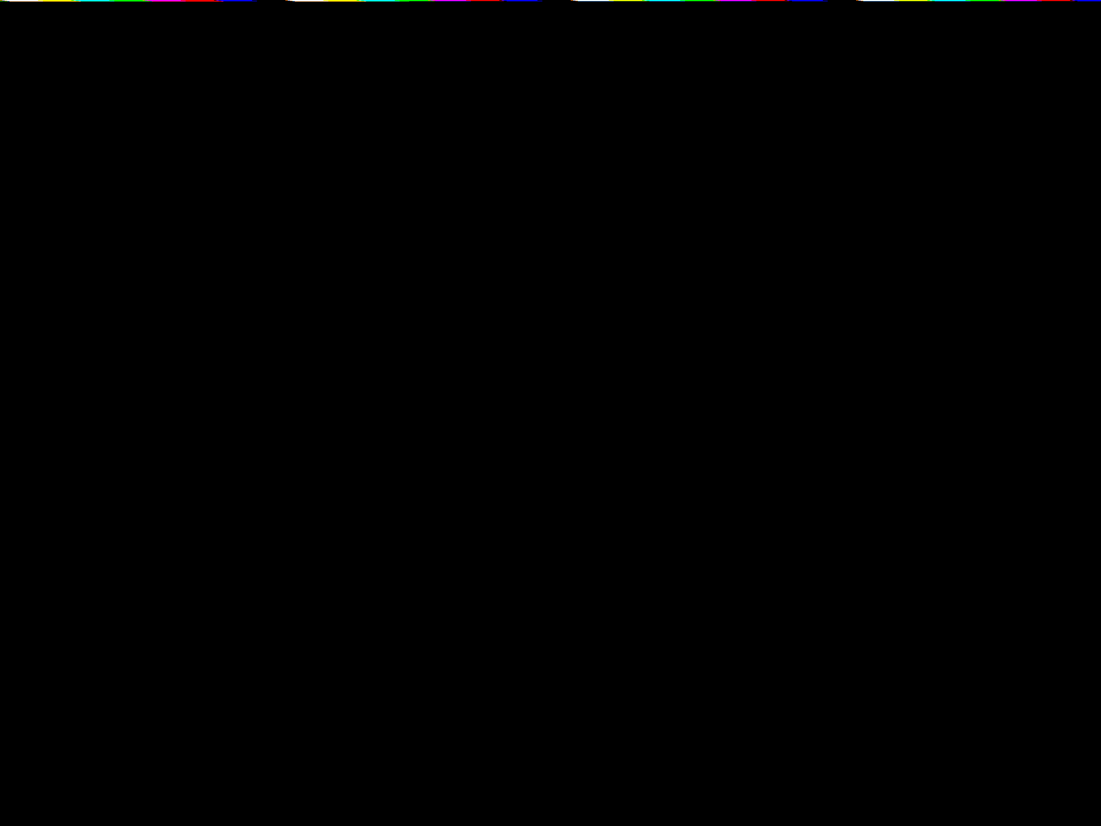

I’m writing a driver for the a sony sensor and getting the following output. The test.raw file is 20MB, all zeroes. Any support would be appreciated.

Are you able to capture frames with qv4l2 ? (You may install it with apt). You may have to increase gain.
No, I cannot capture frames with qv4l2. Attached is the kernel log.
Aug 8 17:52:13 tegra-ubuntu kernel: [ 50.895620] imx294 30-001a: imx294_power_on: power on
Aug 8 17:52:13 tegra-ubuntu kernel: [ 51.024070] imx294 30-001a: imx294_s_stream++,enable:1
Aug 8 17:52:13 tegra-ubuntu kernel: [ 51.031369] imx294 30-001a: imx294_s_stream mode[0]
Aug 8 17:52:14 tegra-ubuntu kernel: [ 52.120562] tegra-vi4 15700000.vi: PXL_SOF syncpt timeout! err = -11
Aug 8 17:52:15 tegra-ubuntu kernel: [ 53.124945] tegra-vi4 15700000.vi: PXL_SOF syncpt timeout! err = -11
Aug 8 17:52:16 tegra-ubuntu kernel: [ 54.129322] tegra-vi4 15700000.vi: PXL_SOF syncpt timeout! err = -11
Aug 8 17:52:17 tegra-ubuntu kernel: [ 55.133681] tegra-vi4 15700000.vi: ATOMP_FE syncpt timeout!
Aug 8 17:52:17 tegra-ubuntu kernel: [ 55.139950] imx294 30-001a: imx294_s_stream++,enable:0
Aug 8 17:52:17 tegra-ubuntu kernel: [ 55.205703] imx294 30-001a: imx294_power_off: power off
I am getting data out now, but it is garbage. Here are updated test results.

Hi ShaneCCC,
I used yavta to get an image out, but the test pattern is only in the upper pixels. Here is an example: Imgur: The magic of the Internet (also attached).
Any idea what the issue could be?
Does the same trace log from #5? From the image it looks like only get one line data that could be the width report by driver is not match the sensor output. You can try reduce the width from the sensor driver to try an error to figure it out.
v4l2-ctl --list-formats-ext can show the resolution to make sure your modification.
Ok, my sensor is outputting RGGB12 and I set my default datafmt to RGGB12 in the driver, yet v4l2-ctl is returning RG10. The resolution is correct though. Here are the results:

From the trace the sensor output more than 2778 lines. Try to increase the sensor driver to increase high.
kworker/5:2-275 [005] ...1 122.342579: rtcpu_vinotify_handle_msg: tstamp:4156521395 tag:CHANSEL_FAULT channel:0x00 frame:0 vi_tstamp:4156520667 data:0x0ada0040
Hi ShaneCCC,
Everything looks good now, thanks for all your help!
