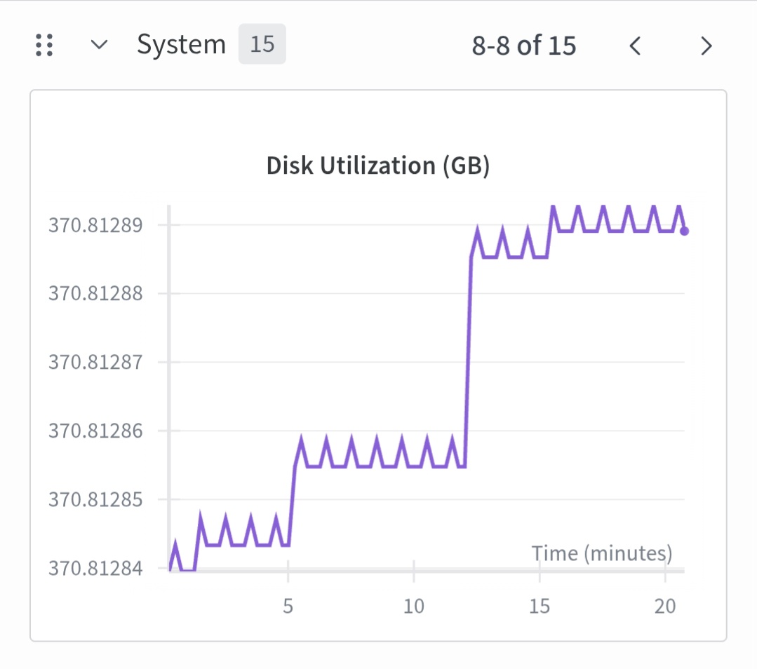

It crashed after 20 minutes ☹️
Here are the run logs and screenshots from run data saved to wandb.ai . There was a disk and memory usage spike just before the crash. Maybe it was trying to write a checkpoint to the disk? On the terminal is just said β€œcrashed” .
______
