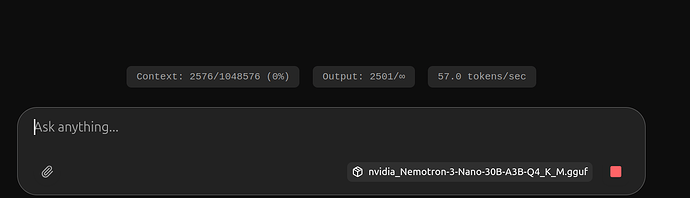

Update: Nemotron 3 Nano 30B running on DGX Spark via llama.cpp! ✅

Performance on DGX Spark (GB10)
| Metric | Value |
| Quantization | Q8_K_XL |
| Model Size | 37.66 GiB |
| GPU VRAM Used | ~38 GiB |
| Prompt Speed | 86 tokens/sec |
| Generation Speed | 43.7 tokens/sec |
| Context Size | 8192 (configurable up to 1M) |
The model includes built-in reasoning (thinking mode) and tool calling support via the chat template.

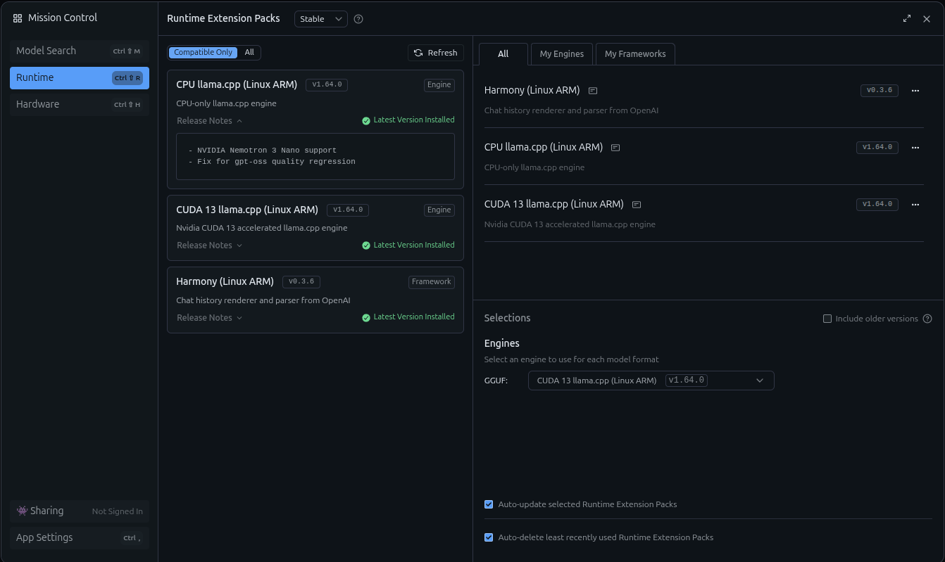

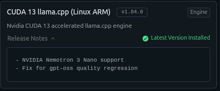

LM Studio is a convenient wrapper for llama.cpp as well

LM Studio NVIDIA/ Q4_K_M is working fine on the spark at 60 TPS
