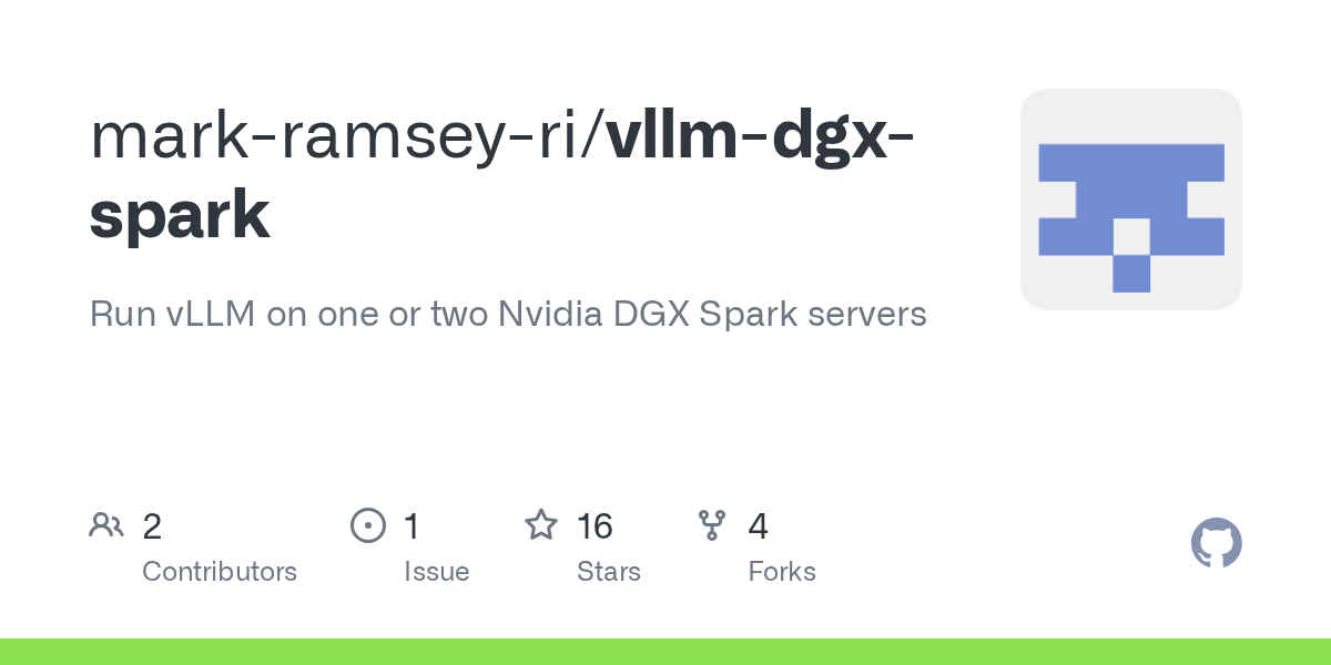

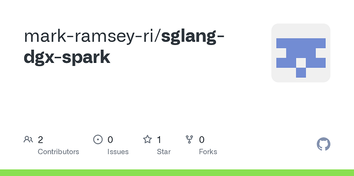

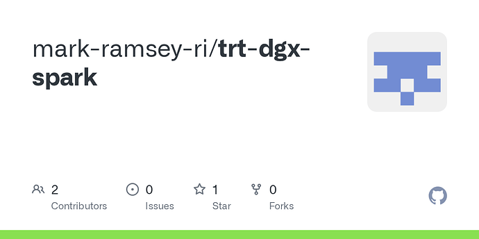

It has been pretty tricky to get two DGX Sparks working as a server for inference models.
I have posted 3 repos on git that provide the same scripts for setup, checkout and benchmarking across two DGX Spark servers for vLLM, SGLang and TensorRT.
Have you tried to run gpt-oss-120b in the cluster using SGLang? What performance are you getting?
The last time I tried, it crashed during inference, so I switched my efforts towards vLLM.
