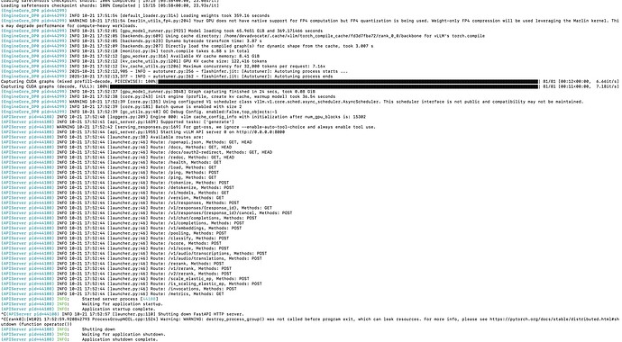

And this is the result when I launch it:
$ uv run vllm serve "openai/gpt-oss-120b" --async-scheduling --port 8000 --host 0.0.0.0 --trust_remote_code --swap-space 16 --max-model-len 32000 --tensor-parallel-size 1 --max-num-seqs 1024 --gpu-memory-utilization 0.7
(APIServer pid=86142) INFO 10-27 13:32:03 [api_server.py:1870] vLLM API server version 0.11.1rc4.dev38+g69f064062.d20251027
(APIServer pid=86142) INFO 10-27 13:32:03 [utils.py:253] non-default args: {'model_tag': 'openai/gpt-oss-120b', 'host': '0.0.0.0', 'model': 'openai/gpt-oss-120b', 'trust_remote_code': True, 'max_model_len': 32000, 'gpu_memory_utilization': 0.7, 'swap_space': 16.0, 'max_num_seqs': 1024, 'async_scheduling': True}
(APIServer pid=86142) INFO 10-27 13:32:06 [model.py:667] Resolved architecture: GptOssForCausalLM
Parse safetensors files: 100%|β–ˆβ–ˆβ–ˆβ–ˆβ–ˆβ–ˆβ–ˆβ–ˆβ–ˆβ–ˆβ–ˆβ–ˆβ–ˆβ–ˆβ–ˆβ–ˆβ–ˆβ–ˆβ–ˆβ–ˆβ–ˆβ–ˆβ–ˆβ–ˆβ–ˆβ–ˆβ–ˆβ–ˆβ–ˆβ–ˆβ–ˆβ–ˆβ–ˆβ–ˆβ–ˆβ–ˆβ–ˆβ–ˆβ–ˆβ–ˆβ–ˆβ–ˆβ–ˆβ–ˆβ–ˆβ–ˆβ–ˆβ–ˆβ–ˆβ–ˆβ–ˆβ–ˆβ–ˆβ–ˆβ–ˆβ–ˆβ–ˆβ–ˆβ–ˆβ–ˆβ–ˆβ–ˆβ–ˆβ–ˆβ–ˆβ–ˆβ–ˆβ–ˆβ–ˆβ–ˆβ–ˆβ–ˆβ–ˆβ–ˆβ–ˆβ–ˆβ–ˆβ–ˆβ–ˆβ–ˆβ–ˆβ–ˆβ–ˆβ–ˆβ–ˆβ–ˆβ–ˆβ–ˆβ–ˆβ–ˆβ–ˆβ–ˆβ–ˆβ–ˆβ–ˆβ–ˆβ–ˆβ–ˆβ–ˆβ–ˆβ–ˆβ–ˆβ–ˆβ–ˆβ–ˆβ–ˆβ–ˆβ–ˆβ–ˆβ–ˆβ–ˆβ–ˆβ–ˆβ–ˆβ–ˆβ–ˆβ–ˆβ–ˆβ–ˆβ–ˆβ–ˆβ–ˆβ–ˆβ–ˆβ–ˆβ–ˆβ–ˆβ–ˆβ–ˆβ–ˆβ–ˆβ–ˆβ–ˆβ–ˆβ–ˆβ–ˆβ–ˆβ–ˆβ–ˆβ–ˆβ–ˆβ–ˆβ–ˆβ–ˆβ–ˆβ–ˆβ–ˆβ–ˆβ–ˆ| 15/15 [00:01<00:00, 14.23it/s]
(APIServer pid=86142) INFO 10-27 13:32:08 [model.py:1778] Using max model len 32000
(APIServer pid=86142) The argument `trust_remote_code` is to be used with Auto classes. It has no effect here and is ignored.
(APIServer pid=86142) INFO 10-27 13:32:08 [scheduler.py:211] Chunked prefill is enabled with max_num_batched_tokens=2048.
(APIServer pid=86142) INFO 10-27 13:32:08 [config.py:272] Overriding max cuda graph capture size to 992 for performance.
(EngineCore_DP0 pid=86247) INFO 10-27 13:32:12 [core.py:93] Initializing a V1 LLM engine (v0.11.1rc4.dev38+g69f064062.d20251027) with config: model='openai/gpt-oss-120b', speculative_config=None, tokenizer='openai/gpt-oss-120b', skip_tokenizer_init=False, tokenizer_mode=auto, revision=None, tokenizer_revision=None, trust_remote_code=True, dtype=torch.bfloat16, max_seq_len=32000, download_dir=None, load_format=auto, tensor_parallel_size=1, pipeline_parallel_size=1, data_parallel_size=1, disable_custom_all_reduce=False, quantization=mxfp4, enforce_eager=False, kv_cache_dtype=auto, device_config=cuda, structured_outputs_config=StructuredOutputsConfig(backend='auto', disable_fallback=False, disable_any_whitespace=False, disable_additional_properties=False, reasoning_parser='openai_gptoss', enable_in_reasoning=False), observability_config=ObservabilityConfig(show_hidden_metrics_for_version=None, otlp_traces_endpoint=None, collect_detailed_traces=None), seed=0, served_model_name=openai/gpt-oss-120b, enable_prefix_caching=True, chunked_prefill_enabled=True, pooler_config=None, compilation_config={'level': None, 'mode': 3, 'debug_dump_path': None, 'cache_dir': '', 'backend': 'inductor', 'custom_ops': ['none'], 'splitting_ops': ['vllm::unified_attention', 'vllm::unified_attention_with_output', 'vllm::unified_mla_attention', 'vllm::unified_mla_attention_with_output', 'vllm::mamba_mixer2', 'vllm::mamba_mixer', 'vllm::short_conv', 'vllm::linear_attention', 'vllm::plamo2_mamba_mixer', 'vllm::gdn_attention', 'vllm::sparse_attn_indexer'], 'use_inductor': None, 'compile_sizes': [], 'inductor_compile_config': {'enable_auto_functionalized_v2': False, 'combo_kernels': True, 'benchmark_combo_kernel': True}, 'inductor_passes': {}, 'cudagraph_mode': <CUDAGraphMode.FULL_AND_PIECEWISE: (2, 1)>, 'use_cudagraph': True, 'cudagraph_num_of_warmups': 1, 'cudagraph_capture_sizes': [1, 2, 4, 8, 16, 24, 32, 40, 48, 56, 64, 72, 80, 88, 96, 104, 112, 120, 128, 136, 144, 152, 160, 168, 176, 184, 192, 200, 208, 216, 224, 232, 240, 248, 256, 272, 288, 304, 320, 336, 352, 368, 384, 400, 416, 432, 448, 464, 480, 496, 512, 528, 544, 560, 576, 592, 608, 624, 640, 656, 672, 688, 704, 720, 736, 752, 768, 784, 800, 816, 832, 848, 864, 880, 896, 912, 928, 944, 960, 976, 992], 'cudagraph_copy_inputs': False, 'full_cuda_graph': True, 'cudagraph_specialize_lora': True, 'use_inductor_graph_partition': False, 'pass_config': {}, 'max_cudagraph_capture_size': 992, 'local_cache_dir': None}
(EngineCore_DP0 pid=86247) /home/codr/.vllm/lib/python3.12/site-packages/torch/cuda/__init__.py:283: UserWarning:
(EngineCore_DP0 pid=86247)     Found GPU0 NVIDIA GB10 which is of cuda capability 12.1.
(EngineCore_DP0 pid=86247)     Minimum and Maximum cuda capability supported by this version of PyTorch is
(EngineCore_DP0 pid=86247)     (8.0) - (12.0)
(EngineCore_DP0 pid=86247)   warnings.warn(
[Gloo] Rank 0 is connected to 0 peer ranks. Expected number of connected peer ranks is : 0
(EngineCore_DP0 pid=86247) INFO 10-27 13:32:18 [parallel_state.py:1325] rank 0 in world size 1 is assigned as DP rank 0, PP rank 0, TP rank 0, EP rank 0
(EngineCore_DP0 pid=86247) INFO 10-27 13:32:18 [gpu_model_runner.py:2849] Starting to load model openai/gpt-oss-120b...
(EngineCore_DP0 pid=86247) INFO 10-27 13:32:18 [cuda.py:400] Using Triton backend on V1 engine.
(EngineCore_DP0 pid=86247) INFO 10-27 13:32:18 [mxfp4.py:143] Using Triton backend
Loading safetensors checkpoint shards:   0% Completed | 0/15 [00:00<?, ?it/s]
Loading safetensors checkpoint shards:   7% Completed | 1/15 [00:31<07:27, 31.98s/it]
Loading safetensors checkpoint shards:  13% Completed | 2/15 [01:01<06:34, 30.35s/it]
Loading safetensors checkpoint shards:  20% Completed | 3/15 [01:33<06:12, 31.07s/it]
Loading safetensors checkpoint shards:  27% Completed | 4/15 [02:05<05:46, 31.52s/it]
Loading safetensors checkpoint shards:  33% Completed | 5/15 [02:38<05:19, 31.94s/it]
Loading safetensors checkpoint shards:  40% Completed | 6/15 [03:03<04:28, 29.84s/it]
Loading safetensors checkpoint shards:  47% Completed | 7/15 [03:28<03:44, 28.05s/it]
Loading safetensors checkpoint shards:  53% Completed | 8/15 [03:46<02:55, 25.06s/it]
Loading safetensors checkpoint shards:  60% Completed | 9/15 [04:10<02:28, 24.68s/it]
Loading safetensors checkpoint shards:  67% Completed | 10/15 [04:37<02:06, 25.38s/it]
Loading safetensors checkpoint shards:  73% Completed | 11/15 [05:01<01:39, 24.97s/it]
Loading safetensors checkpoint shards:  80% Completed | 12/15 [05:25<01:13, 24.61s/it]
Loading safetensors checkpoint shards:  87% Completed | 13/15 [05:51<00:50, 25.11s/it]
Loading safetensors checkpoint shards:  93% Completed | 14/15 [06:09<00:22, 22.90s/it]
Loading safetensors checkpoint shards: 100% Completed | 15/15 [06:34<00:00, 23.63s/it]
Loading safetensors checkpoint shards: 100% Completed | 15/15 [06:34<00:00, 26.32s/it]
(EngineCore_DP0 pid=86247) INFO 10-27 13:38:56 [default_loader.py:314] Loading weights took 395.13 seconds
(EngineCore_DP0 pid=86247) INFO 10-27 13:39:08 [gpu_model_runner.py:2914] Model loading took 68.0744 GiB and 402.666436 seconds
(EngineCore_DP0 pid=86247) INFO 10-27 13:39:13 [backends.py:618] Using cache directory: /home/codr/.cache/vllm/torch_compile_cache/e34e3b9aaa/rank_0_0/backbone for vLLM's torch.compile
(EngineCore_DP0 pid=86247) INFO 10-27 13:39:13 [backends.py:634] Dynamo bytecode transform time: 4.63 s
(EngineCore_DP0 pid=86247) [rank0]:W1027 13:39:13.767000 86247 torch/_inductor/utils.py:1558] [0/0] Not enough SMs to use max_autotune_gemm mode
(EngineCore_DP0 pid=86247) ERROR 10-27 13:39:13 [core.py:779] EngineCore failed to start.

(EngineCore_DP0 pid=86247) ERROR 10-27 13:39:13 [core.py:779]     return forward_call(*args, **kwargs)
(EngineCore_DP0 pid=86247) ERROR 10-27 13:39:13 [core.py:779]            ^^^^^^^^^^^^^^^^^^^^^^^^^^^^^
(EngineCore_DP0 pid=86247) ERROR 10-27 13:39:13 [core.py:779]   File "/home/codr/code/vllm/vllm/model_executor/models/gpt_oss.py", line 705, in forward
(EngineCore_DP0 pid=86247) ERROR 10-27 13:39:13 [core.py:779]     return self.model(input_ids, positions, intermediate_tensors, inputs_embeds)
(EngineCore_DP0 pid=86247) ERROR 10-27 13:39:13 [core.py:779]            ^^^^^^^^^^^^^^^^^^^^^^^^^^^^^^^^^^^^^^^^^^^^^^^^^^^^^^^^^^^^^^^^^^^^^
(EngineCore_DP0 pid=86247) ERROR 10-27 13:39:13 [core.py:779]   File "/home/codr/code/vllm/vllm/compilation/decorators.py", line 408, in __call__
(EngineCore_DP0 pid=86247) ERROR 10-27 13:39:13 [core.py:779]     output = self.compiled_callable(*args, **kwargs)
(EngineCore_DP0 pid=86247) ERROR 10-27 13:39:13 [core.py:779]   File "/home/codr/.vllm/lib/python3.12/site-packages/torch/_dynamo/eval_frame.py", line 845, in compile_wrapper
(EngineCore_DP0 pid=86247) ERROR 10-27 13:39:13 [core.py:779]     raise e.remove_dynamo_frames() from None  # see TORCHDYNAMO_VERBOSE=1
(EngineCore_DP0 pid=86247) ERROR 10-27 13:39:13 [core.py:779]   File "/home/codr/.vllm/lib/python3.12/site-packages/torch/_inductor/compile_fx.py", line 990, in _compile_fx_inner
(EngineCore_DP0 pid=86247) ERROR 10-27 13:39:13 [core.py:779]     raise InductorError(e, currentframe()).with_traceback(
(EngineCore_DP0 pid=86247) ERROR 10-27 13:39:13 [core.py:779]   File "/home/codr/.vllm/lib/python3.12/site-packages/torch/_inductor/compile_fx.py", line 974, in _compile_fx_inner
(EngineCore_DP0 pid=86247) ERROR 10-27 13:39:13 [core.py:779]     mb_compiled_graph = fx_codegen_and_compile(
(EngineCore_DP0 pid=86247) ERROR 10-27 13:39:13 [core.py:779]   File "/home/codr/.vllm/lib/python3.12/site-packages/torch/_inductor/compile_fx.py", line 1695, in fx_codegen_and_compile
(EngineCore_DP0 pid=86247) ERROR 10-27 13:39:13 [core.py:779]     return scheme.codegen_and_compile(gm, example_inputs, inputs_to_check, graph_kwargs)
(EngineCore_DP0 pid=86247) ERROR 10-27 13:39:13 [core.py:779]            ^^^^^^^^^^^^^^^^^^^^^^^^^^^^^^^^^^^^^^^^^^^^^^^^^^^^^^^^^^^^^^^^^^^^^^^^^^^^^
(EngineCore_DP0 pid=86247) ERROR 10-27 13:39:13 [core.py:779]   File "/home/codr/.vllm/lib/python3.12/site-packages/torch/_inductor/compile_fx.py", line 1505, in codegen_and_compile
(EngineCore_DP0 pid=86247) ERROR 10-27 13:39:13 [core.py:779]     compiled_module = graph.compile_to_module()
(EngineCore_DP0 pid=86247) ERROR 10-27 13:39:13 [core.py:779]   File "/home/codr/.vllm/lib/python3.12/site-packages/torch/_inductor/graph.py", line 2319, in compile_to_module
(EngineCore_DP0 pid=86247) ERROR 10-27 13:39:13 [core.py:779]     return self._compile_to_module()
(EngineCore_DP0 pid=86247) ERROR 10-27 13:39:13 [core.py:779]   File "/home/codr/.vllm/lib/python3.12/site-packages/torch/_inductor/graph.py", line 2325, in _compile_to_module
(EngineCore_DP0 pid=86247) ERROR 10-27 13:39:13 [core.py:779]     self.codegen_with_cpp_wrapper() if self.cpp_wrapper else self.codegen()
(EngineCore_DP0 pid=86247) ERROR 10-27 13:39:13 [core.py:779]   File "/home/codr/.vllm/lib/python3.12/site-packages/torch/_inductor/graph.py", line 2271, in codegen
(EngineCore_DP0 pid=86247) ERROR 10-27 13:39:13 [core.py:779]     result = self.wrapper_code.generate(self.is_inference)
(EngineCore_DP0 pid=86247) ERROR 10-27 13:39:13 [core.py:779]   File "/home/codr/.vllm/lib/python3.12/site-packages/torch/_inductor/codegen/wrapper.py", line 1552, in generate
(EngineCore_DP0 pid=86247) ERROR 10-27 13:39:13 [core.py:779]     return self._generate(is_inference)
(EngineCore_DP0 pid=86247) ERROR 10-27 13:39:13 [core.py:779]   File "/home/codr/.vllm/lib/python3.12/site-packages/torch/_inductor/codegen/wrapper.py", line 1615, in _generate
(EngineCore_DP0 pid=86247) ERROR 10-27 13:39:13 [core.py:779]     self.generate_and_run_autotune_block()
(EngineCore_DP0 pid=86247) ERROR 10-27 13:39:13 [core.py:779]   File "/home/codr/.vllm/lib/python3.12/site-packages/torch/_inductor/codegen/wrapper.py", line 1695, in generate_and_run_autotune_block
(EngineCore_DP0 pid=86247) ERROR 10-27 13:39:13 [core.py:779]     raise RuntimeError(f"Failed to run autotuning code block: {e}") from e
(EngineCore_DP0 pid=86247) ERROR 10-27 13:39:13 [core.py:779] torch._inductor.exc.InductorError: RuntimeError: Failed to run autotuning code block: 'JITFunction' object has no attribute 'constexprs'
(EngineCore_DP0 pid=86247) ERROR 10-27 13:39:13 [core.py:779] Set TORCHDYNAMO_VERBOSE=1 for the internal stack trace (please do this especially if you're reporting a bug to PyTorch). For even more developer context, set TORCH_LOGS="+dynamo"
(EngineCore_DP0 pid=86247) Process EngineCore_DP0:
(EngineCore_DP0 pid=86247) Traceback (most recent call last):
(EngineCore_DP0 pid=86247)   File "/usr/lib/python3.12/multiprocessing/process.py", line 314, in _bootstrap
(EngineCore_DP0 pid=86247)     self.run()
(EngineCore_DP0 pid=86247)   File "/usr/lib/python3.12/multiprocessing/process.py", line 108, in run
(EngineCore_DP0 pid=86247)     self._target(*self._args, **self._kwargs)
(EngineCore_DP0 pid=86247)   File "/home/codr/code/vllm/vllm/v1/engine/core.py", line 783, in run_engine_core
(EngineCore_DP0 pid=86247)     raise e
(EngineCore_DP0 pid=86247)   File "/home/codr/code/vllm/vllm/v1/engine/core.py", line 770, in run_engine_core
(EngineCore_DP0 pid=86247)     engine_core = EngineCoreProc(*args, **kwargs)
(EngineCore_DP0 pid=86247)                   ^^^^^^^^^^^^^^^^^^^^^^^^^^^^^^^
(EngineCore_DP0 pid=86247)   File "/home/codr/code/vllm/vllm/v1/engine/core.py", line 538, in __init__
(EngineCore_DP0 pid=86247)     super().__init__(
(EngineCore_DP0 pid=86247)   File "/home/codr/code/vllm/vllm/v1/engine/core.py", line 109, in __init__
(EngineCore_DP0 pid=86247)     num_gpu_blocks, num_cpu_blocks, kv_cache_config = self._initialize_kv_caches(
(EngineCore_DP0 pid=86247)   File "/home/codr/code/vllm/vllm/v1/engine/core.py", line 218, in _initialize_kv_caches
(EngineCore_DP0 pid=86247)     available_gpu_memory = self.model_executor.determine_available_memory()
(EngineCore_DP0 pid=86247)                            ^^^^^^^^^^^^^^^^^^^^^^^^^^^^^^^^^^^^^^^^^^^^^^^^
(EngineCore_DP0 pid=86247)   File "/home/codr/code/vllm/vllm/v1/executor/abstract.py", line 123, in determine_available_memory
(EngineCore_DP0 pid=86247)     return self.collective_rpc("determine_available_memory")
(EngineCore_DP0 pid=86247)            ^^^^^^^^^^^^^^^^^^^^^^^^^^^^^^^^^^^^^^^^^^^^^^^^^
(EngineCore_DP0 pid=86247)   File "/home/codr/code/vllm/vllm/v1/executor/uniproc_executor.py", line 73, in collective_rpc
(EngineCore_DP0 pid=86247)     return [run_method(self.driver_worker, method, args, kwargs)]
(EngineCore_DP0 pid=86247)             ^^^^^^^^^^^^^^^^^^^^^^^^^^^^^^^^^^^^^^^^^^^^^^^^^^^^
(EngineCore_DP0 pid=86247)   File "/home/codr/code/vllm/vllm/v1/serial_utils.py", line 459, in run_method
(EngineCore_DP0 pid=86247)     return func(*args, **kwargs)
(EngineCore_DP0 pid=86247)   File "/home/codr/.vllm/lib/python3.12/site-packages/torch/utils/_contextlib.py", line 120, in decorate_context
(EngineCore_DP0 pid=86247)   File "/home/codr/code/vllm/vllm/v1/worker/gpu_worker.py", line 284, in determine_available_memory
(EngineCore_DP0 pid=86247)     self.model_runner.profile_run()
(EngineCore_DP0 pid=86247)   File "/home/codr/code/vllm/vllm/v1/worker/gpu_model_runner.py", line 3733, in profile_run
(EngineCore_DP0 pid=86247)     hidden_states, last_hidden_states = self._dummy_run(
(EngineCore_DP0 pid=86247)   File "/home/codr/code/vllm/vllm/v1/worker/gpu_model_runner.py", line 3464, in _dummy_run
(EngineCore_DP0 pid=86247)     outputs = self.model(
(EngineCore_DP0 pid=86247)   File "/home/codr/code/vllm/vllm/compilation/cuda_graph.py", line 126, in __call__
(EngineCore_DP0 pid=86247)     return self.runnable(*args, **kwargs)
(EngineCore_DP0 pid=86247)   File "/home/codr/.vllm/lib/python3.12/site-packages/torch/nn/modules/module.py", line 1775, in _wrapped_call_impl
(EngineCore_DP0 pid=86247)     return self._call_impl(*args, **kwargs)
(EngineCore_DP0 pid=86247)   File "/home/codr/.vllm/lib/python3.12/site-packages/torch/nn/modules/module.py", line 1786, in _call_impl
(EngineCore_DP0 pid=86247)     return forward_call(*args, **kwargs)
(EngineCore_DP0 pid=86247)   File "/home/codr/code/vllm/vllm/model_executor/models/gpt_oss.py", line 705, in forward
(EngineCore_DP0 pid=86247)     return self.model(input_ids, positions, intermediate_tensors, inputs_embeds)
(EngineCore_DP0 pid=86247)            ^^^^^^^^^^^^^^^^^^^^^^^^^^^^^^^^^^^^^^^^^^^^^^^^^^^^^^^^^^^^^^^^^^^^^
(EngineCore_DP0 pid=86247)   File "/home/codr/code/vllm/vllm/compilation/decorators.py", line 408, in __call__
(EngineCore_DP0 pid=86247)     output = self.compiled_callable(*args, **kwargs)
(EngineCore_DP0 pid=86247)   File "/home/codr/.vllm/lib/python3.12/site-packages/torch/_dynamo/eval_frame.py", line 845, in compile_wrapper
(EngineCore_DP0 pid=86247)     raise e.remove_dynamo_frames() from None  # see TORCHDYNAMO_VERBOSE=1
(EngineCore_DP0 pid=86247)   File "/home/codr/.vllm/lib/python3.12/site-packages/torch/_inductor/compile_fx.py", line 990, in _compile_fx_inner
(EngineCore_DP0 pid=86247)     raise InductorError(e, currentframe()).with_traceback(
(EngineCore_DP0 pid=86247)   File "/home/codr/.vllm/lib/python3.12/site-packages/torch/_inductor/compile_fx.py", line 974, in _compile_fx_inner
(EngineCore_DP0 pid=86247)     mb_compiled_graph = fx_codegen_and_compile(
(EngineCore_DP0 pid=86247)   File "/home/codr/.vllm/lib/python3.12/site-packages/torch/_inductor/compile_fx.py", line 1695, in fx_codegen_and_compile
(EngineCore_DP0 pid=86247)     return scheme.codegen_and_compile(gm, example_inputs, inputs_to_check, graph_kwargs)
(EngineCore_DP0 pid=86247)            ^^^^^^^^^^^^^^^^^^^^^^^^^^^^^^^^^^^^^^^^^^^^^^^^^^^^^^^^^^^^^^^^^^^^^^^^^^^^^
(EngineCore_DP0 pid=86247)   File "/home/codr/.vllm/lib/python3.12/site-packages/torch/_inductor/compile_fx.py", line 1505, in codegen_and_compile
(EngineCore_DP0 pid=86247)     compiled_module = graph.compile_to_module()
(EngineCore_DP0 pid=86247)   File "/home/codr/.vllm/lib/python3.12/site-packages/torch/_inductor/graph.py", line 2319, in compile_to_module
(EngineCore_DP0 pid=86247)     return self._compile_to_module()
(EngineCore_DP0 pid=86247)   File "/home/codr/.vllm/lib/python3.12/site-packages/torch/_inductor/graph.py", line 2325, in _compile_to_module
(EngineCore_DP0 pid=86247)     self.codegen_with_cpp_wrapper() if self.cpp_wrapper else self.codegen()
(EngineCore_DP0 pid=86247)   File "/home/codr/.vllm/lib/python3.12/site-packages/torch/_inductor/graph.py", line 2271, in codegen
(EngineCore_DP0 pid=86247)     result = self.wrapper_code.generate(self.is_inference)
(EngineCore_DP0 pid=86247)   File "/home/codr/.vllm/lib/python3.12/site-packages/torch/_inductor/codegen/wrapper.py", line 1552, in generate
(EngineCore_DP0 pid=86247)     return self._generate(is_inference)
(EngineCore_DP0 pid=86247)   File "/home/codr/.vllm/lib/python3.12/site-packages/torch/_inductor/codegen/wrapper.py", line 1615, in _generate
(EngineCore_DP0 pid=86247)     self.generate_and_run_autotune_block()
(EngineCore_DP0 pid=86247)   File "/home/codr/.vllm/lib/python3.12/site-packages/torch/_inductor/codegen/wrapper.py", line 1695, in generate_and_run_autotune_block
(EngineCore_DP0 pid=86247)     raise RuntimeError(f"Failed to run autotuning code block: {e}") from e
(EngineCore_DP0 pid=86247) torch._inductor.exc.InductorError: RuntimeError: Failed to run autotuning code block: 'JITFunction' object has no attribute 'constexprs'
(EngineCore_DP0 pid=86247) Set TORCHDYNAMO_VERBOSE=1 for the internal stack trace (please do this especially if you're reporting a bug to PyTorch). For even more developer context, set TORCH_LOGS="+dynamo"
[rank0]:[W1027 13:39:15.693171868 ProcessGroupNCCL.cpp:1524] Warning: WARNING: destroy_process_group() was not called before program exit, which can leak resources. For more info, please see https://pytorch.org/docs/stable/distributed.html#shutdown (function operator())
(APIServer pid=86142) Traceback (most recent call last):
(APIServer pid=86142)   File "/home/codr/.vllm/bin/vllm", line 10, in <module>
(APIServer pid=86142)     sys.exit(main())
(APIServer pid=86142)              ^^^^^^
(APIServer pid=86142)   File "/home/codr/code/vllm/vllm/entrypoints/cli/main.py", line 73, in main
(APIServer pid=86142)     args.dispatch_function(args)
(APIServer pid=86142)   File "/home/codr/code/vllm/vllm/entrypoints/cli/serve.py", line 59, in cmd
(APIServer pid=86142)     uvloop.run(run_server(args))
(APIServer pid=86142)   File "/home/codr/.vllm/lib/python3.12/site-packages/uvloop/__init__.py", line 96, in run
(APIServer pid=86142)     return __asyncio.run(
(APIServer pid=86142)            ^^^^^^^^^^^^^^
(APIServer pid=86142)   File "/usr/lib/python3.12/asyncio/runners.py", line 194, in run
(APIServer pid=86142)     return runner.run(main)
(APIServer pid=86142)            ^^^^^^^^^^^^^^^^
(APIServer pid=86142)   File "/usr/lib/python3.12/asyncio/runners.py", line 118, in run
(APIServer pid=86142)     return self._loop.run_until_complete(task)
(APIServer pid=86142)            ^^^^^^^^^^^^^^^^^^^^^^^^^^^^^^^^^^^
(APIServer pid=86142)   File "uvloop/loop.pyx", line 1518, in uvloop.loop.Loop.run_until_complete
(APIServer pid=86142)   File "/home/codr/.vllm/lib/python3.12/site-packages/uvloop/__init__.py", line 48, in wrapper
(APIServer pid=86142)     return await main
(APIServer pid=86142)   File "/home/codr/code/vllm/vllm/entrypoints/openai/api_server.py", line 1914, in run_server
(APIServer pid=86142)     await run_server_worker(listen_address, sock, args, **uvicorn_kwargs)
(APIServer pid=86142)   File "/home/codr/code/vllm/vllm/entrypoints/openai/api_server.py", line 1930, in run_server_worker
(APIServer pid=86142)     async with build_async_engine_client(
(APIServer pid=86142)   File "/usr/lib/python3.12/contextlib.py", line 210, in __aenter__
(APIServer pid=86142)     return await anext(self.gen)
(APIServer pid=86142)   File "/home/codr/code/vllm/vllm/entrypoints/openai/api_server.py", line 185, in build_async_engine_client
(APIServer pid=86142)     async with build_async_engine_client_from_engine_args(
(APIServer pid=86142)   File "/home/codr/code/vllm/vllm/entrypoints/openai/api_server.py", line 232, in build_async_engine_client_from_engine_args
(APIServer pid=86142)     async_llm = AsyncLLM.from_vllm_config(
(APIServer pid=86142)   File "/home/codr/code/vllm/vllm/utils/func_utils.py", line 116, in inner
(APIServer pid=86142)     return fn(*args, **kwargs)
(APIServer pid=86142)   File "/home/codr/code/vllm/vllm/v1/engine/async_llm.py", line 220, in from_vllm_config
(APIServer pid=86142)     return cls(
(APIServer pid=86142)   File "/home/codr/code/vllm/vllm/v1/engine/async_llm.py", line 142, in __init__
(APIServer pid=86142)     self.engine_core = EngineCoreClient.make_async_mp_client(
(APIServer pid=86142)                        ^^^^^^^^^^^^^^^^^^^^^^^^^^^^^^^^^^^^^^
(APIServer pid=86142)   File "/home/codr/code/vllm/vllm/v1/engine/core_client.py", line 121, in make_async_mp_client
(APIServer pid=86142)     return AsyncMPClient(*client_args)
(APIServer pid=86142)   File "/home/codr/code/vllm/vllm/v1/engine/core_client.py", line 807, in __init__
(APIServer pid=86142)     super().__init__(
(APIServer pid=86142)   File "/home/codr/code/vllm/vllm/v1/engine/core_client.py", line 468, in __init__
(APIServer pid=86142)     with launch_core_engines(vllm_config, executor_class, log_stats) as (
(APIServer pid=86142)   File "/usr/lib/python3.12/contextlib.py", line 144, in __exit__
(APIServer pid=86142)     next(self.gen)
(APIServer pid=86142)   File "/home/codr/code/vllm/vllm/v1/engine/utils.py", line 889, in launch_core_engines
(APIServer pid=86142)     wait_for_engine_startup(
(APIServer pid=86142)   File "/home/codr/code/vllm/vllm/v1/engine/utils.py", line 946, in wait_for_engine_startup
(APIServer pid=86142)     raise RuntimeError(
(APIServer pid=86142) RuntimeError: Engine core initialization failed. See root cause above. Failed core proc(s): {}
Getting the same error. Could be related to the patch I used as it excludes some FP4 support - I’ll see if I can come up with something more localized. If only building VLLM didn’t take THAT much time on this device…
