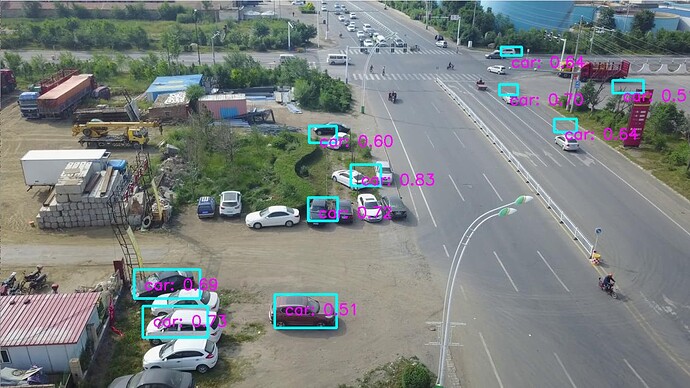

Then using run_ssd_example.py, I predicted objects in the same image. The prediction looks really bad to me…
To me it looks like the training did some things right, but you can see that it is really not good enough.
Please note that this image processing is done with pytorch, and not with TensorRT. When I use detectnet with TensorRT, I get similar results thought.
