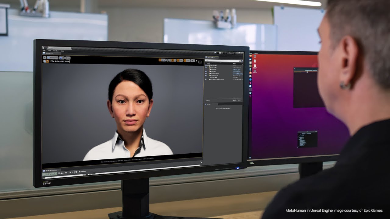

We announced ACE (Omniverse Avatar Cloud Engine) at Siggraph. This will allow live stream of A2F from cloud services to UE MH.
We did a live recorded demo of that, check it out below. And if you missed the full Digital Human section of our special address, check out the link at the bottom too.
Release date wise, we will have more updates on that at GTC in mid Sept. And our goal is as soon as we can. So stay tuned.
ACE
