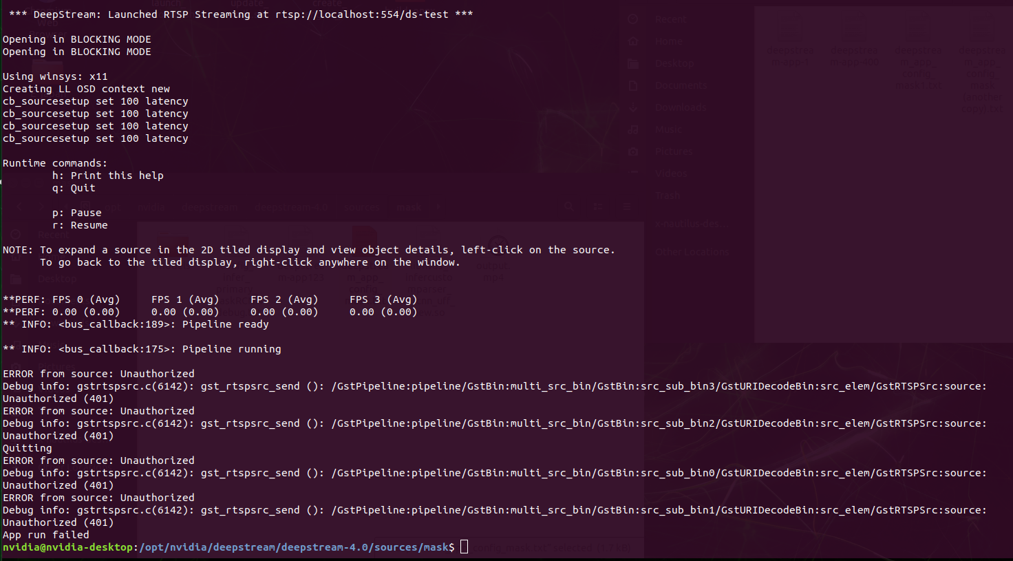

I try to run my Deepstream app with mp4 input file and it’s oke, but when I run with IP camera (rtsp), I got error like bellow image:
This’s my deepstream config file:

How can I fix it?
Can you set “live-source” in group “streammux” to 1 and try? RTSP stream is live source.
I changed “live-source” to 1 but app is not run.
Hi Chen,
Do you have any update?
Can you try just rtsp streaming pipeline first to confirm the gstreamer rtsp streaming function is OK first?
https://www.freedesktop.org/software/gstreamer-sdk/data/docs/latest/gst-plugins-good-plugins-0.10/gst-plugins-good-plugins-rtspsrc.html
Hi Chen,
I run gst-launch by your link, but I get same error when I run my app.
Note: I use Dahua ip camera.
Thank.
There are a lot possible reasons. The rtsp server authorization problem, the firewall, …
Hi Chen,
In the firewall case, I need turn off firewall on my jetson nano device, right?
It depends on the actual network setting of your RTSP server and the jetson device.
If you could try using an RTSP stream that doesn’t involve the @ sign, maybe that helps since the parser is looking for the @ sign to cut the password
Hi thirathorn_b,
You were saved my life :)))))
Thank you so much!
