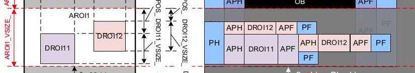

Can Orin NX/Nano support receive the MIPI package with differnt line width in the same frame?
I have a sensor that support package different ROI into the same frame. It appears to produce different lines of data in the same frame. I want to know if Orin NX/Nano MIPI driver can receive and parse it correctly.
Don’t support this kind of case.
