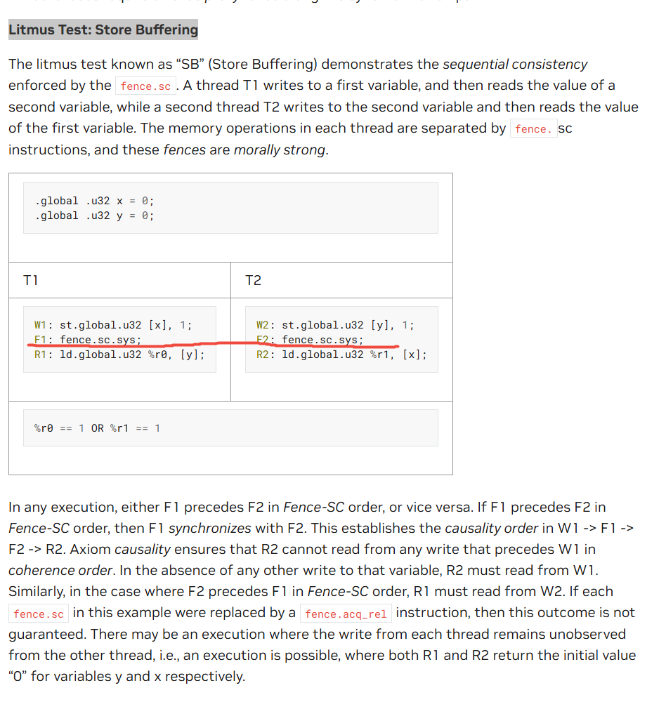

Hi, I found a case maybe can explain it. which I found in cuda ptx doc
the red line here actually is nvshmemi_threadgroup_sync call in nvshmem_barrier,it can make sure that all thread wait here at the same time. In this exactly time, we are sure that both fence.sc.sys(__threadfence_system()) in T1 and T2 are executed in some order. We can assume that F1 preceed F2. So we have W1->F1->F2->R1, which make R2 see the change from T1’s W1. we also have W2->F2->R1, which make R1 see the change from T2’s W2.
Is’t Right?
Store buffering is the canonical litmus test for sequential consistency. However, NVSHMEM is adding a barrier synchronization (i.e. updating and polling on a flag variable) that synchronizes threads after F1/F2 and prior to R1/R2, which may change the strength of memory barrier needed. It would require some careful consideration to determine if acq_rel can be used. As I mentioned earlier, there hasn’t been a performance argument for this, so we’ve used the stronger memory fence. Please let us know if you’re observing better performance with acq_rel fence.
