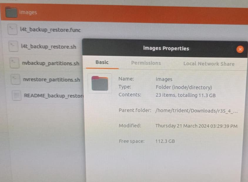

The disk space I refer to is the host PC. If the Jetson has a 28 GB partition, then it will clone both an exact 28 GB bit-for-bit match (raw clone), and it will also produce a “sparse” clone. The sparse clone is almost the same as the raw, but it excludes the content on the partition which is empty. As the content of the partition fills and approaches maximum capacity, then sparse clone size approaches the size of the raw clone. Essentially you can consume twice the space of the partition during a clone (this is also why cloning takes so long). A 28 GB partition, if full, would consume 56 GB on the host PC. Then, if you clone or copy anything else, or install software, this adds to what is consumed. The command “df -H .
” (the “.
” is important, it is an alias for “the current directory”) will tell you what the disk availability is where you are currently located, e.g., in the “Linux_for_Tegra/
” directory (and if that is part of a given partition, then that same answer is true for any location within the partition). You have a large disk, but how much space is free on that partition?

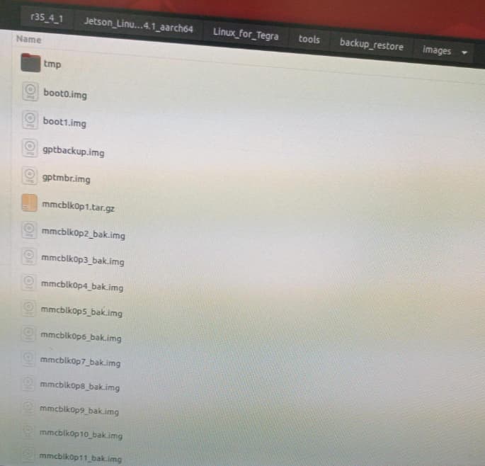

With an external device you probably need to use the scripts from NVIDIA. This gets rather complicated to do in pieces. Backup and restore of just the rootfs partition is simple enough, but it isn’t the whole story. Command line of rootfs backup for a dev kit (keep in mind I don’t know if your AGX Xavier is a dev kit from NVIDIA or if it uses a third party carrier board; also, this runs from the Linux_for_Tegra/
directory):
sudo ./flash.sh -r -k APP -G rootfs_backup.img jetson-agx-xavier-devkit mmcblk0p1

The external disk storage requires special boot preparation. This means that restoring the way I mentioned can put non-rootfs content in which does not work with external boot. This is why the backup and restore script exists…to deal with external media. Backing up the eMMC though is not going to hurt anything, and it is rather important content. There are ways to back up the NVMe if you can mount it on the host PC.
If you have the NVMe on an external host (presumably you’ve removed it from the Jetson and put it on the Linux host PC), and if you have enough disk space to copy an entire NVMe, one can use the dd
tool to directly clone individual partitions or entire NVMe disks. The backup script (the backup_and_restore script, not the commands I showed earlier) will do the right thing if they work, so try that for backup before you use the other methods. However, moving the NVMe to the host PC lets you run the command “lsblk -f

So it is possible to manually backup the eMMC. And to also manually back up the NVMe. It is less complicated if the backup script does this. Restore with the script will restore everything correctly. Restoring manually with the eMMC and NVMe individual backups will not be simple (but it will save everything you need and make surviving failure possible). Remember all that content in partitions of eMMC which are not rootfs? That’s where some of the changes go to boot external content. There is also an initrd involved which might be located in different locations and I can’t guarantee you’d get that partition or file correct when manually backing up pieces. You could restore from this, but it would take work and a learning curve. The backup and restore script has all you need in the README file.
