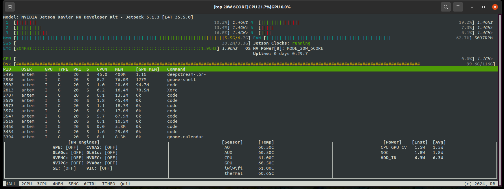

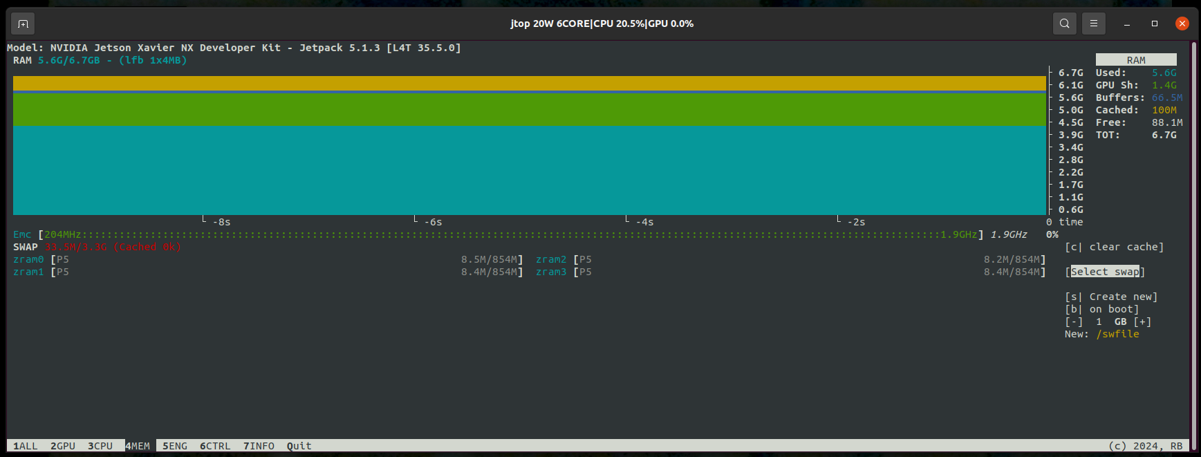

I use a set of microphones and overlay data from them onto the video using NVOSD. Since sound propagates more slowly than light, audio data arrives with a delay compared to the video. Therefore, I need to delay the video by a few frames to overlay the audio data onto the frame that corresponds to the moment the sound was actually emitted.
Concerning CPU/GPU usage, here is what tegrastats returns before and after launching the app:
artem@ubuntu:~$ sudo tegrastats
07-30-2025 18:02:21 RAM 3280/6833MB (lfb 31x4MB) SWAP 0/3417MB (cached 0MB) CPU [2%@1422,2%@1420,10%@1420,4%@1420,off,off] EMC_FREQ 0%@1600 GR3D_FREQ 3%@[306] VIC_FREQ 115 APE 150 AUX@54C CPU@53.5C thermal@53.7C AO@54C GPU@53.5C iwlwifi@52C PMIC@50C VDD_IN 4606mW/4606mW VDD_CPU_GPU_CV 529mW/529mW VDD_SOC 1259mW/1259mW
07-30-2025 18:02:22 RAM 3280/6833MB (lfb 31x4MB) SWAP 0/3417MB (cached 0MB) CPU [8%@1183,15%@1190,30%@1186,17%@1190,off,off] EMC_FREQ 1%@1600 GR3D_FREQ 0%@[306] VIC_FREQ 115 APE 150 AUX@54C CPU@53.5C thermal@53.7C AO@54C GPU@53.5C iwlwifi@52C PMIC@50C VDD_IN 4721mW/4663mW VDD_CPU_GPU_CV 569mW/549mW VDD_SOC 1300mW/1279mW
07-30-2025 18:02:23 RAM 3280/6833MB (lfb 31x4MB) SWAP 0/3417MB (cached 0MB) CPU [6%@1190,4%@1190,1%@1190,0%@1190,off,off] EMC_FREQ 0%@1600 GR3D_FREQ 0%@[306] VIC_FREQ 115 APE 150 AUX@54C CPU@53.5C thermal@53.3C AO@54C GPU@53.5C iwlwifi@52C PMIC@50C VDD_IN 4484mW/4603mW VDD_CPU_GPU_CV 407mW/501mW VDD_SOC 1261mW/1273mW
07-30-2025 18:02:24 RAM 3280/6833MB (lfb 31x4MB) SWAP 0/3417MB (cached 0MB) CPU [4%@1190,1%@1191,1%@1189,2%@1188,off,off] EMC_FREQ 0%@1600 GR3D_FREQ 0%@[306] VIC_FREQ 115 APE 150 AUX@54C CPU@53.5C thermal@53.7C AO@54C GPU@53.5C iwlwifi@56C PMIC@50C VDD_IN 4443mW/4563mW VDD_CPU_GPU_CV 366mW/467mW VDD_SOC 1261mW/1270mW
07-30-2025 18:02:25 RAM 3340/6833MB (lfb 31x4MB) SWAP 0/3417MB (cached 0MB) CPU [23%@1420,67%@1419,5%@1426,4%@1416,off,off] EMC_FREQ 0%@1600 GR3D_FREQ 0%@[306] NVENC 499 VIC_FREQ 115 APE 150 AUX@54.5C CPU@54C thermal@53.7C AO@54C GPU@53.5C iwlwifi@54C PMIC@50C VDD_IN 5128mW/4676mW VDD_CPU_GPU_CV 936mW/561mW VDD_SOC 1341mW/1284mW
07-30-2025 18:02:26 RAM 3388/6833MB (lfb 31x4MB) SWAP 0/3417MB (cached 0MB) CPU [15%@1420,39%@1419,3%@1421,4%@1420,off,off] EMC_FREQ 0%@1600 GR3D_FREQ 6%@[306] VIC_FREQ 0%@115 APE 150 AUX@54C CPU@54C thermal@54.2C AO@54C GPU@53.5C iwlwifi@55C PMIC@50C VDD_IN 5006mW/4731mW VDD_CPU_GPU_CV 814mW/603mW VDD_SOC 1341mW/1293mW
07-30-2025 18:02:27 RAM 3538/6833MB (lfb 22x4MB) SWAP 0/3417MB (cached 0MB) CPU [9%@1420,97%@1420,2%@1420,5%@1420,off,off] EMC_FREQ 1%@1600 GR3D_FREQ 0%@[306] VIC_FREQ 115 APE 150 AUX@54C CPU@54C thermal@54C AO@54C GPU@53.5C iwlwifi@55C PMIC@50C VDD_IN 5128mW/4788mW VDD_CPU_GPU_CV 936mW/651mW VDD_SOC 1300mW/1294mW
07-30-2025 18:02:28 RAM 3561/6833MB (lfb 22x4MB) SWAP 0/3417MB (cached 0MB) CPU [7%@1420,98%@1420,1%@1420,2%@1421,off,off] EMC_FREQ 0%@1600 GR3D_FREQ 19%@[306] VIC_FREQ 115 APE 150 AUX@54C CPU@54C thermal@53.85C AO@54C GPU@54C iwlwifi@55C PMIC@50C VDD_IN 5088mW/4825mW VDD_CPU_GPU_CV 936mW/686mW VDD_SOC 1300mW/1295mW
07-30-2025 18:02:29 RAM 3660/6833MB (lfb 26x4MB) SWAP 0/3417MB (cached 0MB) CPU [8%@1417,98%@1420,10%@1418,12%@1419,off,off] EMC_FREQ 1%@1600 GR3D_FREQ 3%@[306] VIC_FREQ 115 APE 150 AUX@54C CPU@54C thermal@54C AO@54.5C GPU@53.5C iwlwifi@54C PMIC@50C VDD_IN 5413mW/4890mW VDD_CPU_GPU_CV 1178mW/741mW VDD_SOC 1341mW/1300mW
07-30-2025 18:02:30 RAM 3811/6833MB (lfb 17x4MB) SWAP 0/3417MB (cached 0MB) CPU [7%@1421,99%@1420,2%@1420,8%@1420,off,off] EMC_FREQ 1%@1600 GR3D_FREQ 3%@[306] VIC_FREQ 115 APE 150 AUX@54.5C CPU@54.5C thermal@53.85C AO@54C GPU@53.5C iwlwifi@53C PMIC@50C VDD_IN 5210mW/4922mW VDD_CPU_GPU_CV 976mW/764mW VDD_SOC 1341mW/1304mW
07-30-2025 18:02:31 RAM 3849/6833MB (lfb 12x4MB) SWAP 0/3417MB (cached 0MB) CPU [9%@1417,96%@1423,4%@1420,4%@1420,off,off] EMC_FREQ 1%@1600 GR3D_FREQ 0%@[306] VIC_FREQ 0%@115 APE 150 AUX@54.5C CPU@54.5C thermal@53.85C AO@54C GPU@54C iwlwifi@52C PMIC@50C VDD_IN 5291mW/4956mW VDD_CPU_GPU_CV 1099mW/795mW VDD_SOC 1341mW/1307mW
07-30-2025 18:02:32 RAM 3850/6833MB (lfb 12x4MB) SWAP 0/3417MB (cached 0MB) CPU [8%@1415,87%@1421,1%@1420,11%@1418,off,off] EMC_FREQ 1%@1600 GR3D_FREQ 1%@[204] VIC_FREQ 115 APE 150 AUX@54C CPU@54C thermal@54C AO@54C GPU@54C iwlwifi@52C PMIC@50C VDD_IN 5210mW/4977mW VDD_CPU_GPU_CV 1017mW/813mW VDD_SOC 1300mW/1307mW
07-30-2025 18:02:33 RAM 3935/6833MB (lfb 8x4MB) SWAP 0/3417MB (cached 0MB) CPU [10%@1422,3%@1420,50%@1408,48%@1419,off,off] EMC_FREQ 1%@1600 GR3D_FREQ 1%@[204] VIC_FREQ 115 APE 150 AUX@54C CPU@54C thermal@53.85C AO@54.5C GPU@53.5C iwlwifi@52C PMIC@50C VDD_IN 5128mW/4988mW VDD_CPU_GPU_CV 936mW/823mW VDD_SOC 1341mW/1309mW
07-30-2025 18:02:34 RAM 4192/6833MB (lfb 13x1MB) SWAP 0/3417MB (cached 0MB) CPU [9%@1420,6%@1420,96%@1420,13%@1420,off,off] EMC_FREQ 1%@1600 GR3D_FREQ 39%@[204] VIC_FREQ 115 APE 150 AUX@54C CPU@54C thermal@53.85C AO@54.5C GPU@53.5C iwlwifi@52C PMIC@50C VDD_IN 5332mW/5013mW VDD_CPU_GPU_CV 1017mW/836mW VDD_SOC 1341mW/1312mW
07-30-2025 18:02:35 RAM 4280/6833MB (lfb 12x1MB) SWAP 0/3417MB (cached 0MB) CPU [9%@1421,6%@1421,99%@1420,5%@1420,off,off] EMC_FREQ 1%@1600 GR3D_FREQ 1%@[306] VIC_FREQ 115 APE 150 AUX@54C CPU@54C thermal@54.2C AO@54.5C GPU@54C iwlwifi@56C PMIC@50C VDD_IN 5169mW/5023mW VDD_CPU_GPU_CV 976mW/846mW VDD_SOC 1300mW/1311mW
07-30-2025 18:02:36 RAM 4443/6833MB (lfb 3x1MB) SWAP 0/3417MB (cached 0MB) CPU [29%@1420,36%@1419,74%@1419,22%@1419,off,off] EMC_FREQ 2%@1600 GR3D_FREQ 5%@[306] NVENC 499 NVENC1 499 VIC_FREQ 0%@115 APE 150 AUX@54.5C CPU@54.5C thermal@54.2C AO@54.5C GPU@54C iwlwifi@52C PMIC@50C VDD_IN 5779mW/5071mW VDD_CPU_GPU_CV 1341mW/877mW VDD_SOC 1503mW/1323mW
07-30-2025 18:02:37 RAM 4494/6833MB (lfb 1x1MB) SWAP 0/3417MB (cached 0MB) CPU [76%@1421,31%@1419,53%@1420,54%@1418,off,off] EMC_FREQ 2%@1600 GR3D_FREQ 0%@[408] VIC_FREQ 0%@115 APE 150 AUX@54.5C CPU@54.5C thermal@54.2C AO@54.5C GPU@54C iwlwifi@52C PMIC@50C VDD_IN 5902mW/5119mW VDD_CPU_GPU_CV 1422mW/909mW VDD_SOC 1503mW/1333mW
07-30-2025 18:02:38 RAM 4533/6833MB (lfb 1x1MB) SWAP 1/3417MB (cached 0MB) CPU [72%@1419,12%@1420,29%@1420,35%@1421,off,off] EMC_FREQ 1%@1600 GR3D_FREQ 0%@[408] VIC_FREQ 10%@115 APE 150 AUX@54.5C CPU@54.5C thermal@54.2C AO@54.5C GPU@54C iwlwifi@52C PMIC@50C VDD_IN 5576mW/5145mW VDD_CPU_GPU_CV 1178mW/924mW VDD_SOC 1463mW/1340mW
07-30-2025 18:02:39 RAM 4604/6833MB (lfb 4x256kB) SWAP 1/3417MB (cached 0MB) CPU [70%@1418,67%@1419,83%@1421,77%@1419,off,off] EMC_FREQ 3%@1600 GR3D_FREQ 6%@[408] NVENC 499 VIC_FREQ 0%@115 APE 150 AUX@54.5C CPU@55C thermal@54.35C AO@54.5C GPU@54C iwlwifi@52C PMIC@50C VDD_IN 6583mW/5220mW VDD_CPU_GPU_CV 1869mW/973mW VDD_SOC 1663mW/1357mW
07-30-2025 18:02:40 RAM 4625/6833MB (lfb 1x512kB) SWAP 1/3417MB (cached 0MB) CPU [84%@1420,88%@1420,79%@1419,90%@1419,off,off] EMC_FREQ 3%@1600 GR3D_FREQ 0%@[408] VIC_FREQ 115 APE 150 AUX@55C CPU@55C thermal@54.5C AO@54.5C GPU@54C iwlwifi@55C PMIC@50C VDD_IN 6583mW/5289mW VDD_CPU_GPU_CV 1950mW/1022mW VDD_SOC 1582mW/1369mW
07-30-2025 18:02:41 RAM 4625/6833MB (lfb 1x512kB) SWAP 1/3417MB (cached 0MB) CPU [83%@1420,92%@1420,88%@1419,81%@1420,off,off] EMC_FREQ 3%@1600 GR3D_FREQ 24%@[408] VIC_FREQ 115 APE 150 AUX@54.5C CPU@55C thermal@54.35C AO@54.5C GPU@54C iwlwifi@52C PMIC@50C VDD_IN 6502mW/5346mW VDD_CPU_GPU_CV 1910mW/1064mW VDD_SOC 1541mW/1377mW
07-30-2025 18:02:42 RAM 4639/6833MB (lfb 1x256kB) SWAP 1/3417MB (cached 0MB) CPU [41%@1421,30%@1420,30%@1420,24%@1421,off,off] EMC_FREQ 3%@1600 GR3D_FREQ 3%@[306] VIC_FREQ 115 APE 150 AUX@54.5C CPU@54.5C thermal@54.5C AO@54.5C GPU@54C iwlwifi@58C PMIC@50C VDD_IN 5372mW/5347mW VDD_CPU_GPU_CV 976mW/1060mW VDD_SOC 1503mW/1383mW
07-30-2025 18:02:43 RAM 4597/6833MB (lfb 1x512kB) SWAP 1/3417MB (cached 0MB) CPU [9%@1190,17%@1188,5%@1266,11%@1267,off,off] EMC_FREQ 1%@1600 GR3D_FREQ 0%@[306] VIC_FREQ 115 APE 150 AUX@54.5C CPU@54.5C thermal@54.2C AO@54C GPU@54C iwlwifi@53C PMIC@50C VDD_IN 4884mW/5327mW VDD_CPU_GPU_CV 569mW/1039mW VDD_SOC 1422mW/1384mW
07-30-2025 18:02:44 RAM 4598/6833MB (lfb 3x512kB) SWAP 1/3417MB (cached 0MB) CPU [26%@1190,19%@1191,23%@1192,30%@1189,off,off] EMC_FREQ 1%@1600 GR3D_FREQ 0%@[306] VIC_FREQ 115 APE 150 AUX@54.5C CPU@54C thermal@54.35C AO@54.5C GPU@53.5C iwlwifi@53C PMIC@50C VDD_IN 5088mW/5317mW VDD_CPU_GPU_CV 773mW/1028mW VDD_SOC 1463mW/1387mW
07-30-2025 18:02:45 RAM 4595/6833MB (lfb 3x512kB) SWAP 1/3417MB (cached 0MB) CPU [10%@1189,13%@1190,6%@1190,5%@1190,off,off] EMC_FREQ 0%@1600 GR3D_FREQ 6%@[306] VIC_FREQ 115 APE 150 AUX@54.5C CPU@54C thermal@54.05C AO@54.5C GPU@54C iwlwifi@52C PMIC@50C VDD_IN 4843mW/5298mW VDD_CPU_GPU_CV 569mW/1009mW VDD_SOC 1422mW/1389mW
07-30-2025 18:02:46 RAM 4591/6833MB (lfb 1x2MB) SWAP 2/3417MB (cached 0MB) CPU [25%@1420,13%@1420,19%@1420,7%@1420,off,off] EMC_FREQ 0%@1600 GR3D_FREQ 3%@[306] VIC_FREQ 115 APE 150 AUX@54.5C CPU@54.5C thermal@54.05C AO@54.5C GPU@54C iwlwifi@56C PMIC@50C VDD_IN 5006mW/5287mW VDD_CPU_GPU_CV 691mW/997mW VDD_SOC 1463mW/1392mW
07-30-2025 18:02:48 RAM 4596/6833MB (lfb 1x2MB) SWAP 5/3417MB (cached 0MB) CPU [19%@1342,19%@1343,25%@1343,20%@1343,off,off] EMC_FREQ 1%@1600 GR3D_FREQ 0%@[306] VIC_FREQ 115 APE 150 AUX@54.5C CPU@54.5C thermal@54.2C AO@54.5C GPU@54C iwlwifi@52C PMIC@50C VDD_IN 5088mW/5280mW VDD_CPU_GPU_CV 732mW/987mW VDD_SOC 1463mW/1394mW
07-30-2025 18:02:49 RAM 4596/6833MB (lfb 1x2MB) SWAP 5/3417MB (cached 0MB) CPU [20%@1190,17%@1190,19%@1189,16%@1190,off,off] EMC_FREQ 1%@1600 GR3D_FREQ 0%@[306] VIC_FREQ 115 APE 150 AUX@54.5C CPU@54C thermal@54.05C AO@54.5C GPU@53.5C iwlwifi@52C PMIC@50C VDD_IN 4965mW/5268mW VDD_CPU_GPU_CV 651mW/975mW VDD_SOC 1422mW/1395mW
07-30-2025 18:02:50 RAM 4597/6833MB (lfb 1x2MB) SWAP 5/3417MB (cached 0MB) CPU [8%@1188,3%@1190,0%@1190,3%@1190,off,off] EMC_FREQ 0%@1600 GR3D_FREQ 0%@[306] VIC_FREQ 115 APE 150 AUX@54.5C CPU@54C thermal@54.05C AO@54.5C GPU@54C iwlwifi@52C PMIC@50C VDD_IN 4680mW/5248mW VDD_CPU_GPU_CV 447mW/957mW VDD_SOC 1422mW/1396mW
I am a beginner at deepstream development, so I don’t know how to interpret it correctly, but it doesn’t seem to me that CPU and GPU are overloaded

1.This is the GPU usage of test2 on AGX orin. GR3D_FREQ is the GPU usage percentage. I set the profile to MAXN (frq 1.3G), and the GPU usage is about 30-40%.
Please try setting it to MAXN and observe the GPU usage during program running.
Your Xavier NX GPU runs at 200-400Mhz, but the usage is lower. This data may be problematic. You also can try using jtop GitHub - rbonghi/jetson_stats: 📊 Simple package for monitoring and control your NVIDIA Jetson [Orin, Xavier, Nano, TX] series
GR3D_FREQ 22%@[1300,1290] NVENC off NVDEC 7%@115 NVJPG off NVJPG1 off VIC 44%@115 OFA off NVDLA0 off NVDLA1 off PVA0_FREQ off APE 174 cpu@49.406C soc2@46.218C soc0@45.781C gpu@44.093C tj@49.5C soc1@44.5C VDD_GPU_SOC 7268mW/7125mW VDD_CPU_CV 1530mW/1530mW VIN_SYS_5V0 4543mW/4543mW
GR3D_FREQ 34%@[1300,1287] NVENC off NVDEC 46%@115 NVJPG off NVJPG1 off VIC 46%@128 OFA off NVDLA0 off NVDLA1 off PVA0_FREQ off APE 174 cpu@49.312C soc2@46.343C soc0@45.75C gpu@44.343C tj@49.312C soc1@44.656C VDD_GPU_SOC 7268mW/7141mW VDD_CPU_CV 1530mW/1530mW VIN_SYS_5V0 4543mW/4543mW
GR3D_FREQ 43%@[1300,1300] NVENC off NVDEC 16%@115 NVJPG off NVJPG1 off VIC 25%@115 OFA off NVDLA0 off NVDLA1 off PVA0_FREQ off APE 174 cpu@49.5C soc2@46.218C soc0@45.718C gpu@44.281C tj@49.437C soc1@44.593C VDD_GPU_SOC 7268mW/7153mW VDD_CPU_CV 1530mW/1530mW VIN_SYS_5V0 4543mW/4543mW
GR3D_FREQ 27%@[1300,1300] NVENC off NVDEC 51%@115 NVJPG off NVJPG1 off VIC 59%@140 OFA off NVDLA0 off NVDLA1 off PVA0_FREQ off APE 174 cpu@49.625C soc2@46.25C soc0@45.968C gpu@44.593C tj@49.625C soc1@44.531C VDD_GPU_SOC 7268mW/7164mW VDD_CPU_CV 1530mW/1530mW VIN_SYS_5V0 4543mW/4543mW
