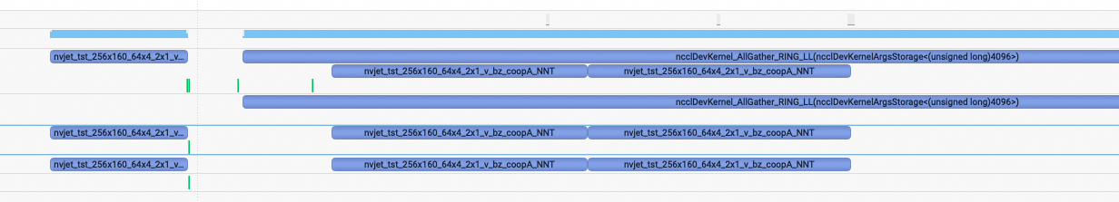

Root Cause Analysis with Nsight Systems (nsys)
The nsys
profile provides a clear picture of what’s happening on my H100 GPU, which has 132 SMs:
- The
gemm
kernel is perfectly sized, launching exactly 132 blocks. In an ideal scenario, this should complete in a single wave, fully utilizing all SMs. - However, the concurrent
ncclAllGather
kernel launches 24 blocks, preemptively occupying a few SMs. - As a result, the CUDA scheduler can only dispatch less than 132 blocks of the
gemm
kernel in the first wave. - The remaining blocks of the
gemm
kernel are forced into a second wave.
This creates a severe tail effect. During the second wave, the GPU is massively underutilized: only a few SMs are busy with the gemm
tail, and another 24 SMs are busy with the allgather
kernel, leaving most SMs completely idle. This wastage of resources is the primary cause of the performance degradation.
