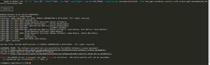

CUDA initialization failure with error Error 802: system not yet initialized
I am trying to run tensortllm bench for deepseek model with a custom docker image and below is my docker command. My cuda (12.8) gpu driver installation is correct and all 8 B200 gpu are correctly shown in nvidia-smi output.
docker run --rm -it --gpus all --network host --ipc host --privileged --cap-add SYS_PTRACE --security-opt seccomp=unconfined --name test_gpu evuedsoacr.azurecr.io/dc-ecosys-appl-eng/deepseek_tensorrt_llm:release bash
Despite that I keep getting below failure from the docker image
