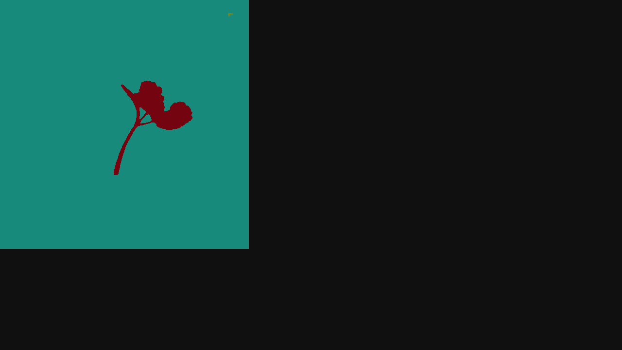

• How to reproduce the issue ?
Model has 5 classes.
Model was trained witch custom image dataset, using the TAO unet notebook. There it was trained, pruned, and retrained, and exported. Inference was tested. I’m showing a colorized inferevce mask produced from within the TAO docker:
Setup the nvcr.io/nvidia/deepstream-6.0.1-devel, installing deepstream_tao_apps
moved my custom model to tyhe docker and converted there with:
tao-converter -k nvidia_tlt -p input_1,1x3x512x512,4x3x512x512,16x3x512x512 -t fp16 -e ./6S001_fp16.engine ./trtfp32.6s01.etlt
run the TAO app within the docker as:
/apps/tao_segmentation/ds-tao-segmentation -c ./configs/peopleSemSegNet_tao/pgie_peopleSemSegNet_tao_configC.txt -i /home/david/Envs/TAO/6S001/data/images/test/0009.jpg
With this config file pgie_peopleSemSegNet_tao_configC.txt (2.1 KB)
with
num-detected-classes=5
But the image segmentation output has only 2 classes:
The output image at 1280X720 is also much larger than the 512X512 of the model
Thanks for the help!!
How about the result under fp32 mode?
BTW, actually in your 2nd picture, there are at least 3 classes. I can see an object in the top right corner.
I did, same identical result in fp32 mode.
I see what you say about the third class. But the more obvious classifications are not happening, while they do happen with tao unet inference.
tao-converter -k nvidia_tlt -p input_1,1x3x512x512,4x3x512x512,16x3x512x512 -t fp32 -e ./6S001_fp32.engine ./trtfp32.6s01.etlt
model-engine-file=../../models/peopleSemSegNet/6S001_fp32.engine
./apps/tao_segmentation/ds-tao-segmentation -c ./configs/peopleSemSegNet_tao/pgie_peopleSemSegNet_tao_configC.txt -i /home/david/Envs/TAO/6S001/data/images/test/0009.jpg
Could you try to check the pixel value of output image? Are there totally 5 kinds of pixel value?
More, to narrow down, please try to use “tao unet infernece xxx” to run against the .engine file or .trt file generated by deepstream.
The exported model is fp16 but the config file is for int8

Morganh: There are only three classes in the output image.
As far as running “tao unet infernece xxx” , the first image on this post was generated from with the tao notebook by:

UPDATE:
After downgrading on the host computer the same versions of tensorRT, CUDA and cuDNN as in the docker images, and rebuilding openCV from source… I was able to do the following tests:
  1. Regenerated the trt engine from the tao toolkit notebook
  2. Used the same engine for tao inference within the tao notebook
  3. Used the same engine for deepstream inference from tao apps
  4. Used the same engine for C++ inference
In addition,
  1. Run inference from deepstream tao apps using the original retrained etlt
Sadly, there is no change. tao inference produces the expected good results, the rest do not.
Is there a way to have the deepstream tao app to output the image mask?
Here are the output images:
  1. from tao inference
  2. from deepstream etlt
  3. from deepstream trt engine
4 from C++
There is an easy solution. You can refer to https://github.com/NVIDIA-AI-IOT/deepstream_tao_apps/blob/master/configs/unet_tao/pgie_unet_tao_config.txt#L33
You just need to put your .etlt model to the models folder.
