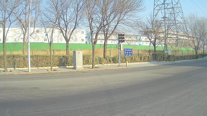

This will load a local jpeg file and decode it to rgba. The source sample.jpeg and the result rgba file’s screenshot is uploaded.
Should notice the decoded image’s bottom rows are blurred, and the full image seems like scaled a little but the width*height is still kept(click to open the attached image, and use mouse to switch between them, the different is easy to get noticed).
