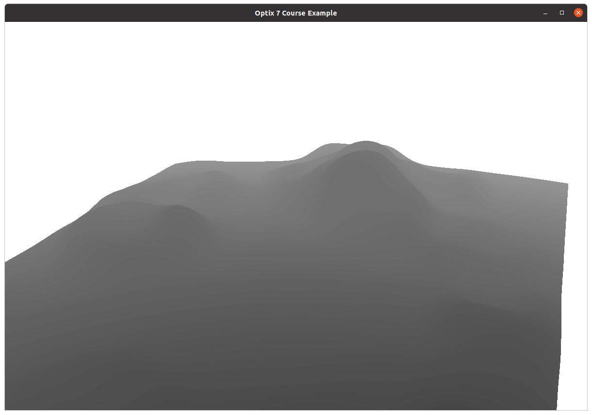

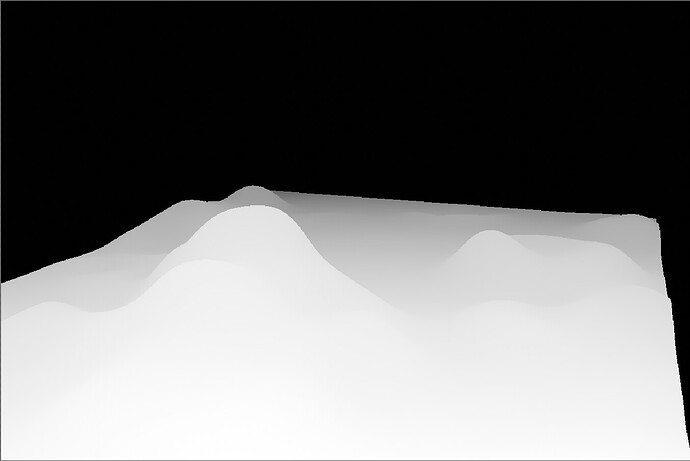

This works to render a depth image. However, there striations present in the image. I guess these are due to some kind clipping in the depth values from the way they are being send back to the host?

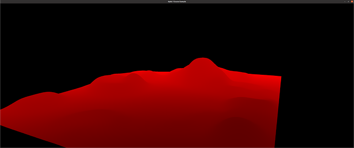

I can also render an image when following the RayCasting Example, but it gives a red hued image. I think I partially understand why, but I also have no experience in OpenGL so I was unable to figure out how to render just one channel.
So I have been trying understand where these striations are coming from. My first thought is had something to do with going back and forth between int and float, but I just don’t have enough experience in this yet to really understand what is going on in each conversion. I wanted to see if I could inspect the data directly, but was having trouble even just printing values to the terminal. I finally figured out to save the image to a file, instead of a rendering to a window. However, I can only save the rgb image and not the depth image. The rgb image saves upside down(probably easy to fix), but the depths just shows a bunch of squares like an invisible layer. While debugging this, I tried changing the call to optixGetRayTMax() and defined it as const float t = optixGetRayTMax() ; To my surprise, this seemed to get rid of the striations.
I am not sure if I am just not wanting to see them, or they are not there, but it seems better. However, can you explain why this would be the case? I am really hoping to develop a better understanding/intuition about these seemingly simple questions.
Is there a better way to get the depth? As I mentioned previously, I eventually want to be able to render a bunch of sparse images from various points, so I want to make sure I am setting this up in an efficient manner.
If you only store one channel, that is usually interpreted by image viewers as the red channel, so that would explain your red screenshots.
When writing out the floating point intersection distance values into an image, some care would need to be taken, because the range of the distance values is not limited! (Well, it’s limited to what you used as maximum ray tmax in your optixTrace calls.)
So if you store these floating point values into some image file format which only supports a limited amount of bits like that RGBA8 format used in some OptiX SDK examples, you cannot simply write the original depth when that has values outside the unsigned byte range [0, 255] but would need to scale them to get a more reasonable result shown in image viewers.
So the banding you see in the grey depth image is most likely due to the quantization of a continuous floating point distance to discrete values in an integer format of the destination image channels. (Or you’re still using the unsigned int type for the distance values.)
You would need to consider how you want the distance be scaled for visualization. That your missed pixels are full white means they are the farthest away. probably well outside [0, 255] range of unsigned byte channels.
If you want to keep that image format (instead of HDR), then you could scale the hit distance results before writing it into the image so that the nearest distance is 0.0f and the farthest distance is 1.0f, then scale that to the byte image range [0, 255].
That way you would have the full possible 256 values for the depth visualization and the nearest point would be black and the farthest would be white, or inverse that for more pleasing visualizations.
The much simpler and more accurate way would be to store the image into some format which supports higher channel resolutions, e.g. *.hdr images can be RGBA_FP32, so full floating point 32 bit values per channel. Means you can simply store the RGB and Distance values directly.
