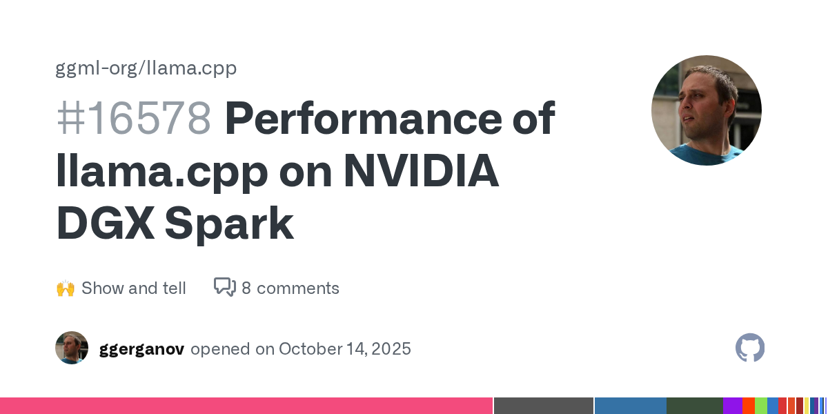

based on the performance numbers rolling in for the DGX Spark I am going to wait for the 20 Petaflop version of the DGX workstation.
Which one did you see?
The values of the original llama.cpp looks much better than those from Ollama that popped up first. At least for the big MoEs. So it might be worth to wait while optimized kernels for FP4 are available to be used vLLM, SGLang.
If not seen yet, the best review on YouTube is the one by Level1Techs who do see the full potential of that box.
