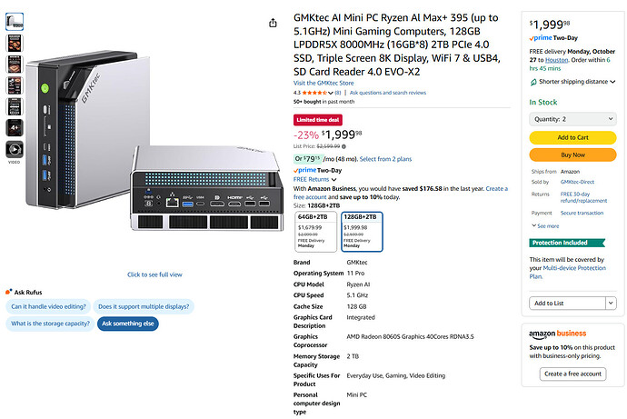

I also just noticed the Ryzen Al Max+ 395 with 128GB 2TB is being sold by GMKtec on Amazon for $1,999.99 with 2-day delivery
Curious if they are making the price more appealing to move out units if the DGX Sparks significantly outperform them but that’s a dramatic cost difference if their performance is comparable for AI model build/training.
Corsair, HP, the popular with geeks Framework, and other vendors are offering desktop like systems with Ryzen AI MAX+395 chips, all prices around $2000 or less, selling for months before Spark shipped, but none of them compare or can beat the DGX-Spark!

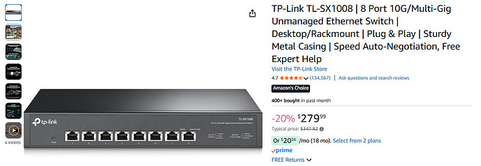

I ordered this switch and cables from Amazon that arrive on Monday as well since I didn’t have an Ethernet splitter.

My false assumption was that I only need one of the two devices on normal ethernet. Connect X-7 is networking (high speed at 200 Gb/s). I have no reason to doubt that it will work, I simply need to get both on ethernet and ran out of ports on my old switch (so I am upgrading). Networking isn’t my thing, so feel to correct me if I said something wrong.
