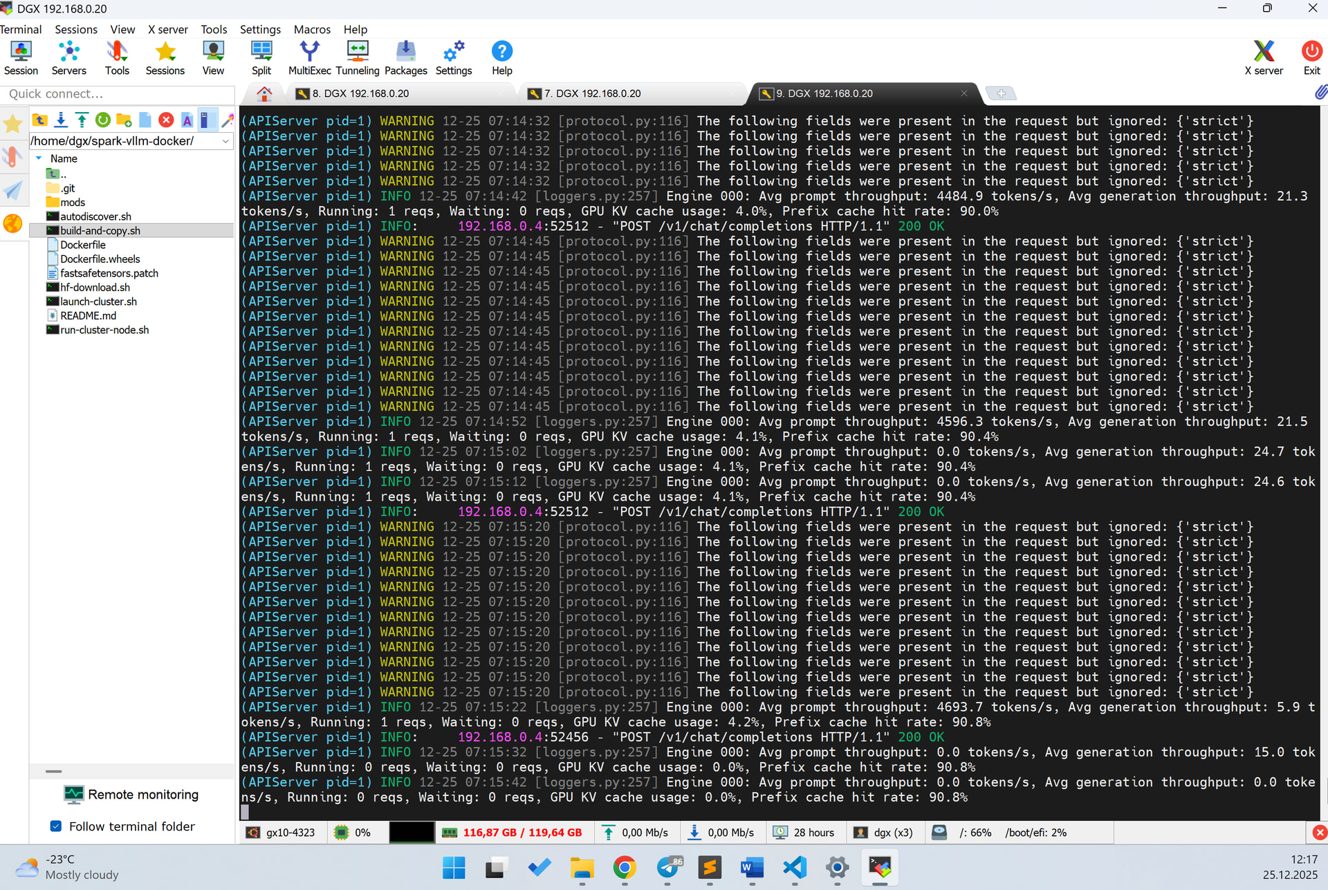

I was able to get Roo Code + gpt-oss-120B on DGX Spark working reliably (at least for Tools / function calling) using a vLLM container build from:
https://github.com/eugr/spark-vllm-docker
What works
  • OpenAI-compatible /v1/chat/completions
  • Tools / function calling works consistently (model returns tool_calls correctly).
  • Roo Code can drive tool calls as long as it uses tool_choice: "auto" (gpt-oss behavior).
What does not (yet) work “fully”
  • Strict / structured outputs in the OpenAI sense is not fully supported in this path. If the client sends strict, vLLM logs that it is ignored. For my use case this wasn’t critical—the key point was having stable tool calling.
Why I didn’t use NIM
I tested the NIM gpt-oss-120B container on DGX Spark, but it does not work on GB10 in my environment (looks like GB10 / CC 12.1 support is not enabled in that container build yet). So I couldn’t get a working NIM runtime for gpt-oss-120B on this hardware.

Proof of tool calling
A request like this returns a valid tool_calls block (with content: null, which is expected in tool-call turns):
  "tool_choice": "auto",
  "tools": [
      "type": "function",
      "function": {
        "name": "get_time",
        "parameters": {
          "type": "object",
          "properties": { "city": { "type": "string" } },
          "required": ["city"]
Bottom line
If your priority is Roo Code + stable Tools/function calling on DGX Spark + gpt-oss-120B, the vLLM runtime from spark-vllm-docker is currently the most practical path I’ve found.
If someone has a NIM image/tag that truly enables GB10 for gpt-oss-120B, I’d be interested to test it, but right now I can’t get NIM working on DGX Spark for this model.
