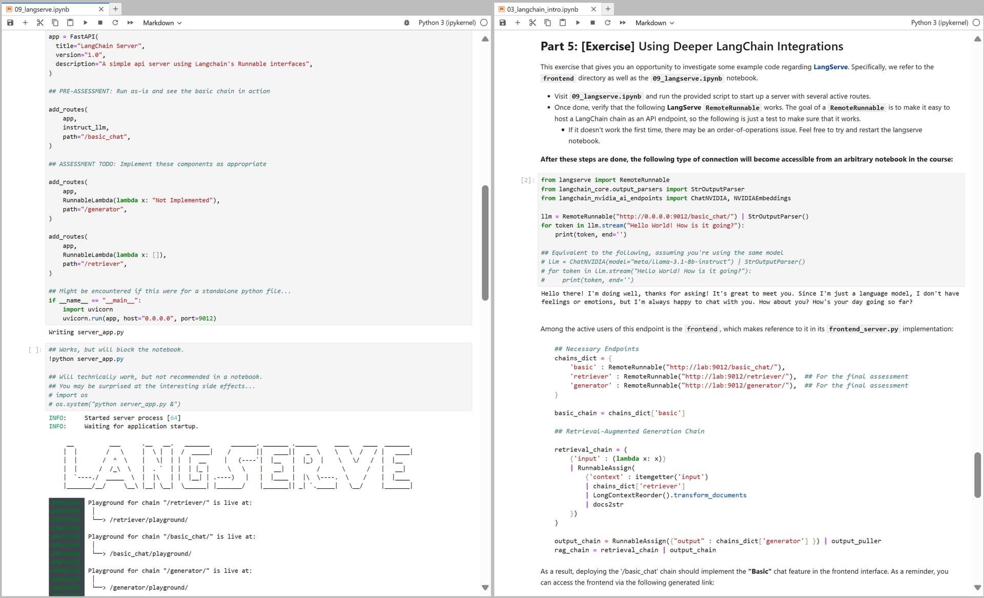

Hey @klingl
That’s an awesome attempt actually! The course doesn’t expect you to do all of this: rather, it expects you to use the already-existing server running in :8090, whereas you are just supposed to launch your endpoints from notebook 9 using LangServe (i.e. this syntax: langserve/examples/local_llm/server.py at main · langchain-ai/langserve). The frontend which is already running in 0.0.0.0:8090 (where 0.0.0.0 is just going to be relative to host url here) is just expecting the routes defined on 0.0.0.0:9012. If you wanted to keep using your solution format as an exercise, you’d just need to launch to port 9012 instead of port 8090 and then see if it works (It shouldn’t be too far off, but I have a feeling your endpoint won’t support streaming very well…)
In other words, the already-running front-end is making calls like this, which need fulfillment:
from langserve import RemoteRunnable
from langchain_core.output_parsers import StrOutputParser
llm = RemoteRunnable("http://0.0.0.0:9012/basic_chat/") | StrOutputParser()
for token in llm.stream("Hello World! How is it going?"):
    print(token, end='')
You can see the running server’s implementation in the frontend directory, but shouldn’t be trying to override it.
Hello @vkudlay,
I have tried also running file 09, only code cells 1 and 3 in their original form and also on a fresh instance with no existing ports running. Even this does not work to setup and connect the frontend. I have updated my codebase to use 9012 as you suggested and still have issues. I cannot understand where the issue is coming from.
I appreciate your efforts to help. I just need the server configged.
I just tested it out and it looks like it all works. When you get the chance, can you try these steps from a clean start:
  1. Run cells 1 and 2 in Notebook 9. Cell 1 defines the endpoint server which the frontend is relying on. /basic is already implemented and should enable the Basic route in the Frontend. Cell 2 (python !python server_app.py) kickstarts the server in the background of the notebook.
  2. Run the second-to-last cells in Notebook 3. This tests out the endpoint running from Notebook 9. If you get a stream there, you should get a response in the frontend.
This seemed to work for me, at least, and the solution just involves tweaking the server in NB9. Please let me know if it doesn’t work for you.
Hi @vkudlay ,
I have rewritten the code to be simpler as suggested. Gradio is now running but is throwing an error 422 which I am unable to fix. I do not understand what is going on here. Any help would be appreciated.
%%writefile server_app.py
# https://python.langchain.com/docs/langserve#server
from fastapi import FastAPI
from langchain_nvidia_ai_endpoints import ChatNVIDIA, NVIDIAEmbeddings
from langserve import add_routes

app = FastAPI(
  title="LangChain Server",
  version="1.0",
  description="A simple api server using Langchain's Runnable interfaces",
## PRE-ASSESSMENT: Run as-is and see the basic chain in action
add_routes(
    app,
    instruct_llm,
    path="/basic_chat",
## ASSESSMENT TODO: Implement these components as appropriate
add_routes(
    app,
    generator_chain,
    path="/generator",
add_routes(
    app,
    retrieval_chain,
    path="/retriever",
## Might be encountered if this were for a standalone python file...
if __name__ == "__main__":
    import uvicorn
    uvicorn.run(app, host="0.0.0.0", port=9012)
@vkudlay I am running into the same problem, getting a client error: ‘422 Unprocessable Entity’, same code as here. Could you please help. I am on this for around 5 hours now. Not able to figure out.
