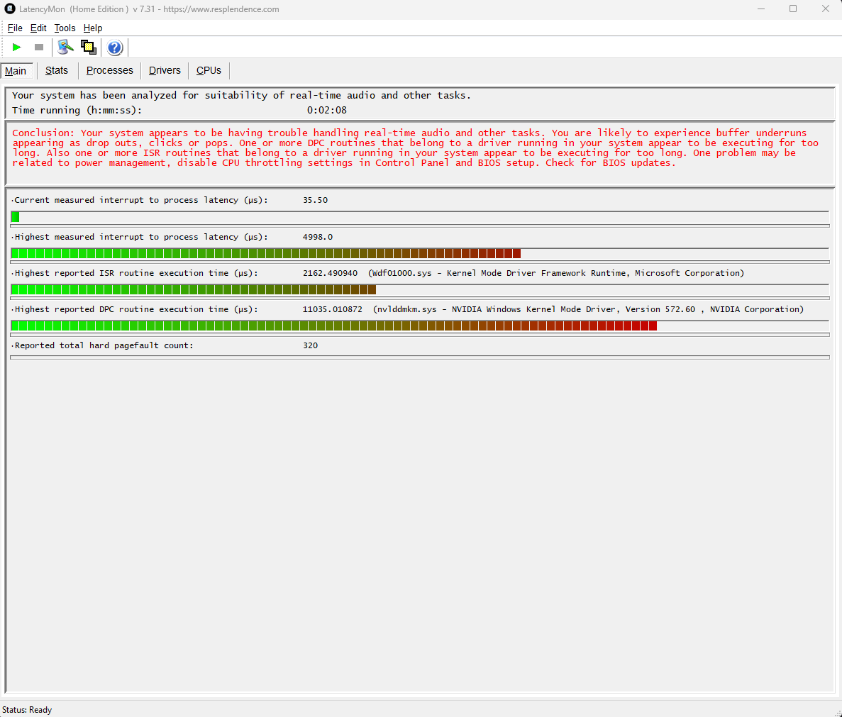

Issue persists in 572.60 . Have enabled ultra low latency and prefer max performance. Have tried uninstalling - DDU - clean install. Still persists. Very frustrating.

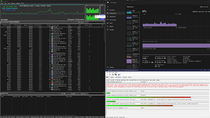

You don’t need an Apple computer to work with low latency audio without problems. My i7 12700k with Nvidia 4090 runs smooth and without audio glitches, but you have to know how to configure it.
  1. I use a program called Process Lasso to enable turbo mode to the processor preventing unused threads from being parked.
  2. With Nvidia Profile Inspector I created a profile for Ableton where it auto-activates the maximum performance mode of the gpu when starting Ableton.
With those two simple instructions it should work perfectly for you.
