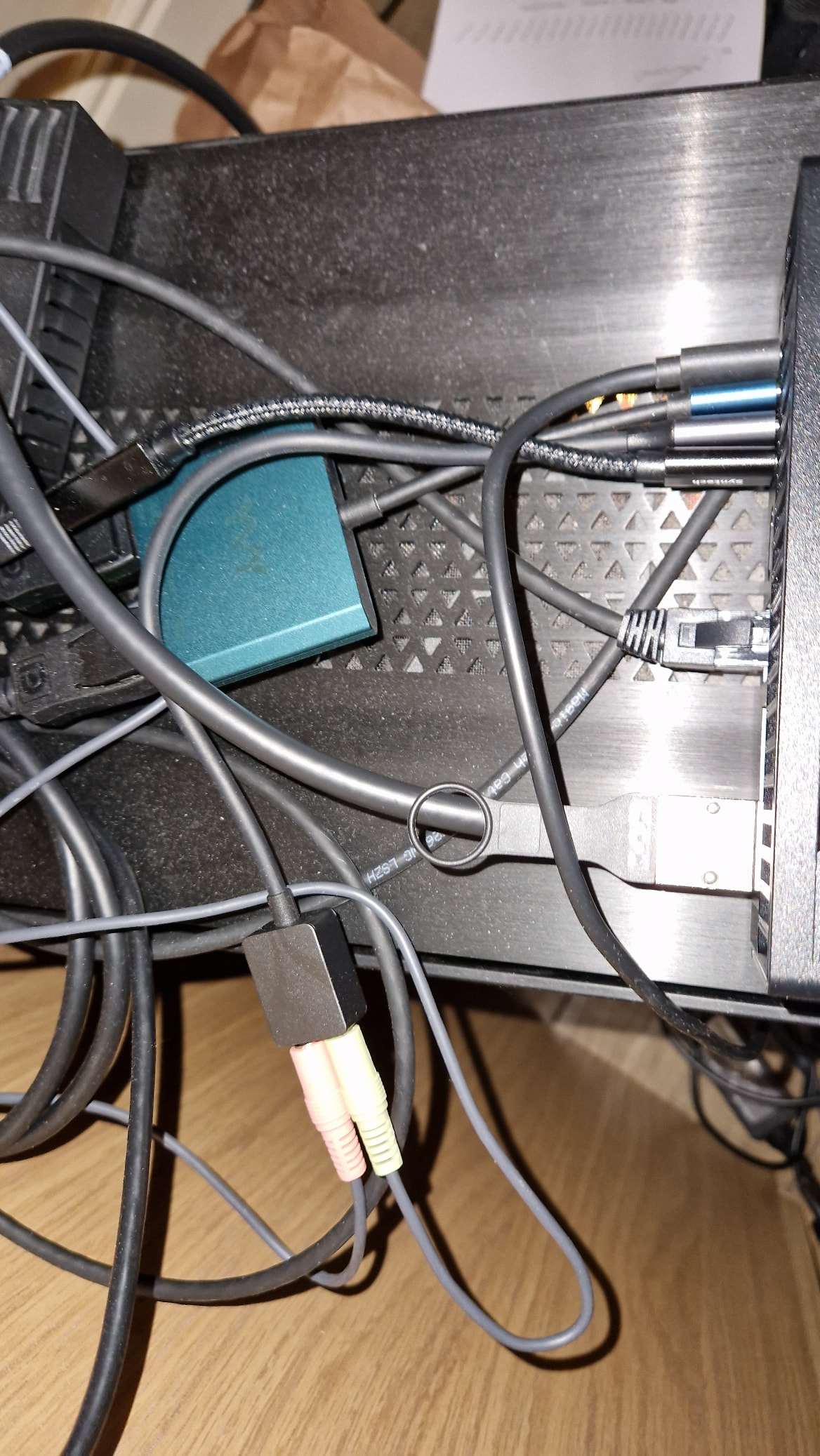

Just trying to work out, are you pushing air into the front of the GB10, allowing the cables out the open end of the enclosure, are are you pulling air out the back (in which case we’d be looking for somewhere to do some cable management and a hole to exit the cables). I have quite few gubbins at the back of mine right now, I do mostly run headless, but it is connected to 2x Displayports + Audio & USB hub for HID devices on my KVM switch.

Yes the 3U version is pushing air in the front.
