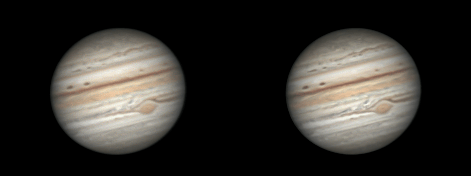

EVA is a real-time system that mitigates atmospheric turbulence.
EVA provides real-time videos of Moon and planets :
jup_result

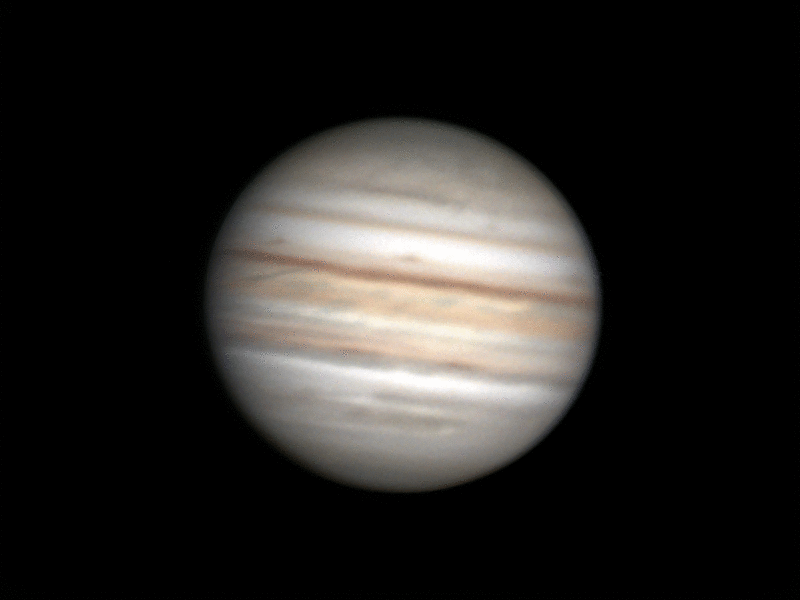

Hello everybody,
The turbulence can be weak, normal or strong.
EVA (Electronic Visual Assistant) analyses in real time a sequence of continuous raw images to define, depending on the turbulence, a degradation model applicable to these raw images.
The nature of the turbulence may change from sequence to sequence.
The model which will be implemented in 2022, will be tested on the Moon, Mars, Jupiter and Saturn.
The first tests show that this method makes it possible to recover images even in very degraded conditions which is not the case, among amateurs, with current approaches.
On the other hand, the method also works for long distance turbulence and underwater turbulence.
When this method will be fully tested, at the end of 2022, an Linux on-board version will be offered to all those who experience the inconvenience of atmospheric and underwater turbulence: amateur astronomers, long-distance surveillance, wildlife photographers, underwater photographers, etc.
A website dedicated to GPU vision will be open in 2022 so that everyone can follow the operations in progress.
jup_captures

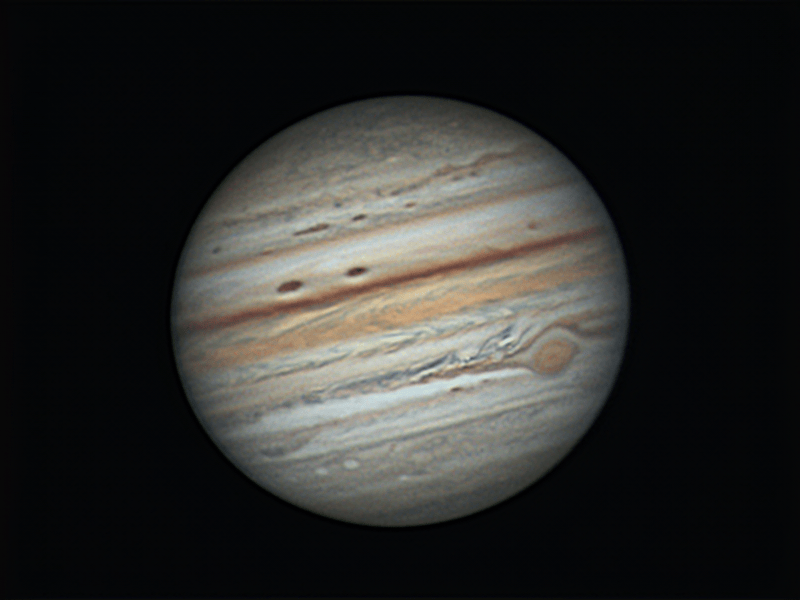

turbu software automatically selects the best number of frames depending on the turbulence :
Yes, I use wavelets filtering, patch denoising and precise optical flow.
Latest version of turbu works at 180 fps (5400 raw frames stacked in 30 seconds).
Comparison with the image of an amateur astronomer :
The difference is that the image on the left (15-minute derotation) is obtained automatically and that the images of the assisted video used for the derotation are obtained live.
A single end-to-end processing software: turbu.
For the left image, telescope used is a C11 @ f/20 on EQ6-R Pro.
The images (800x600) on the left are obtained live every 30 seconds (visual assisted) while the images on the right are obtained every 3.5 minutes (derotation of 7 images).
The visual aspect is practically identical.
jup_video

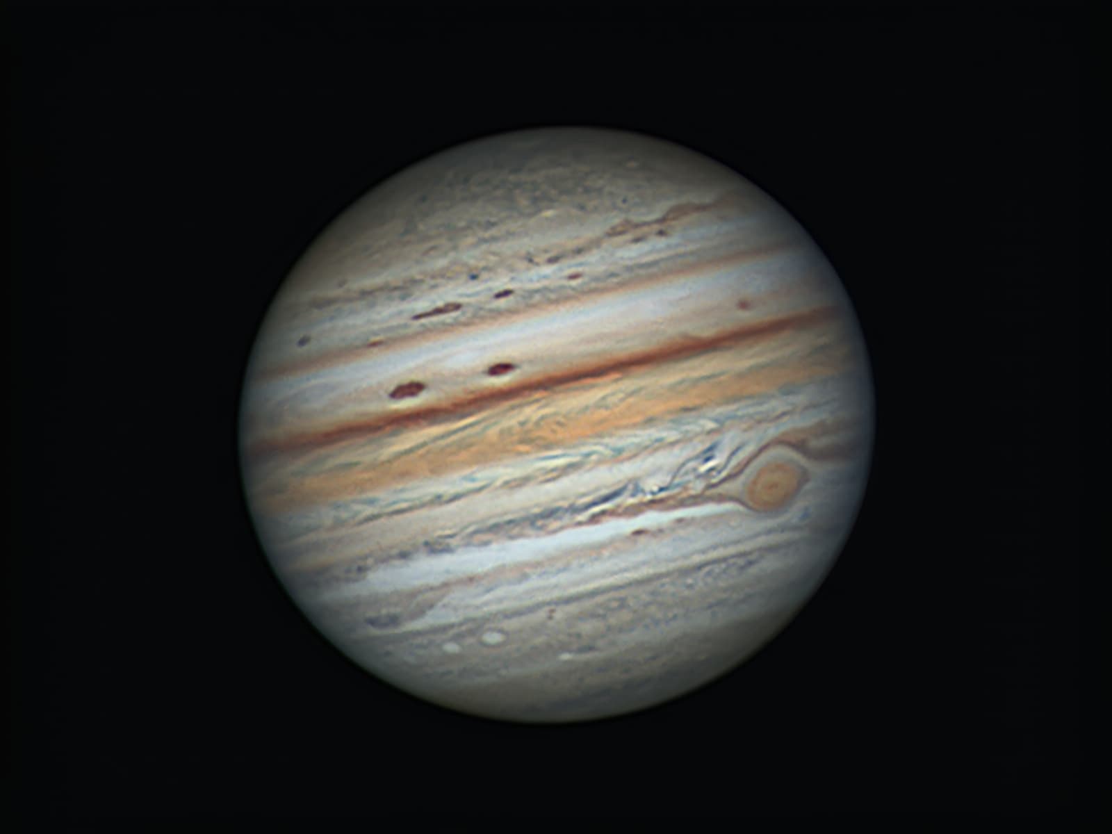

Another treatment of the video from August 11, 2021 with a more faithful rendering of details and colors.
jup_VA_1

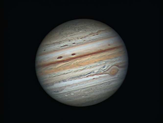

With some nice details :
New treatments :
Super resolution x2 :
More details :
A new HR treatment :
from this series of images :
jup_hr

Jupiter in super resolution :
