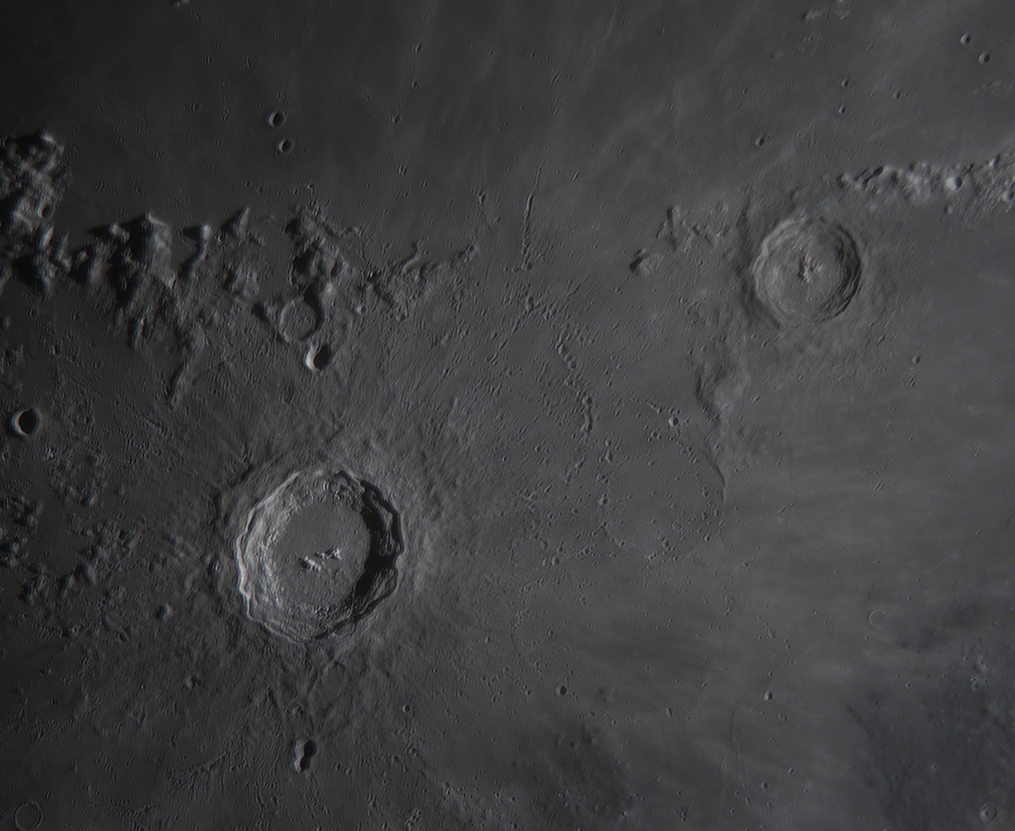

yesterday, the sky waq clear, the turbulence was low and the Moon was quite high in the sky.
Some classical results with good telescope collimation, as this topic is about astronomy :
