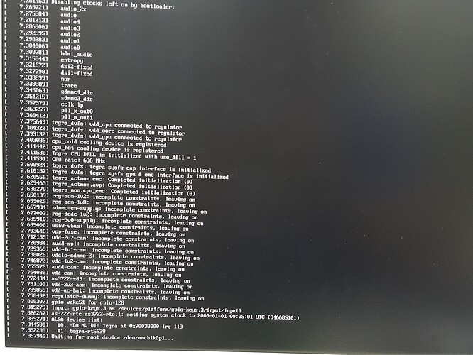

EMMC change to Sandisk iNAND 7232 fail
We had change EMMC to Sandisk iNAND 7232 (e.MMC 5.1 with Command-Queue and HS400 Interface)
but we met a problem!
when boot the tk1, it’s stop to
waiting for root device /dev/mmcblk0p1
TK1 only supports up to eMMC 4.51
Hi Guys,
We are facing with very strange problem on bootloader. We created custom board based on TK1 CD575M - A1 with SDIN8DE4 - 16G Taiwan made one and SKYHYNIX CFR-PBA 4 rams. We did full SHMOO test successfully and created necessary files. Successfully flashed IMG files in to the system. However, system stops on very early stage of the booting.
It is very strange because when we flash android os on this exact same system it works. Last month, we made 10pcs of exact same sample boards which were working fine. When we flash L4T in to this system, it shows following error. Please help us to sort out this issue guys. Thanks!
Here I attached my log and i have no clue with this problem at all.
U-Boot SPL 2014.10-rc2-g3127911 (Jun 07 2016 - 21:00:01)
U-Boot 2014.10-rc2-g3127911 (Jun 07 2016 - 21:00:01)
TEGRA124
Board: NVIDIA Jetson TK1
I2C:   ready
DRAM:  2 GiB
MMC:   Tegra SD/MMC: 0, Tegra SD/MMC: 1
*** Warning - bad CRC, using default environment
tegra-pcie: PCI regions:
tegra-pcie:   I/O: 0x12000000-0x12010000
tegra-pcie:   non-prefetchable memory: 0x13000000-0x20000000
tegra-pcie:   prefetchable memory: 0x20000000-0x40000000
tegra-pcie: 2x1, 1x1 configuration
ERROR: tegra-pcie: failed to power on PHY: -110
at /dvs/git/dirty/git-master_linux/3rdparty/u-boot/drivers/pci/pci_tegra.c:740/)
ERROR: tegra-pcie: failed to enable controller
at /dvs/git/dirty/git-master_linux/3rdparty/u-boot/drivers/pci/pci_tegra.c:1055)
In:    serial
Out:   serial
Err:   serial
Net:   No ethernet found.
Hit any key to stop autoboot:  0
MMC: no card present
switch to partitions #0, OK
mmc0(part 0) is current device
Scanning mmc 0...
GPT: last_usable_lba incorrect: 1D58FFF > 1D52000
get_partition_info_efi: *** ERROR: Invalid GPT ***
GPT: my_lba incorrect: 1D59FFF != 1D51FFF
get_partition_info_efi: *** ERROR: Invalid Backup GPT ***
