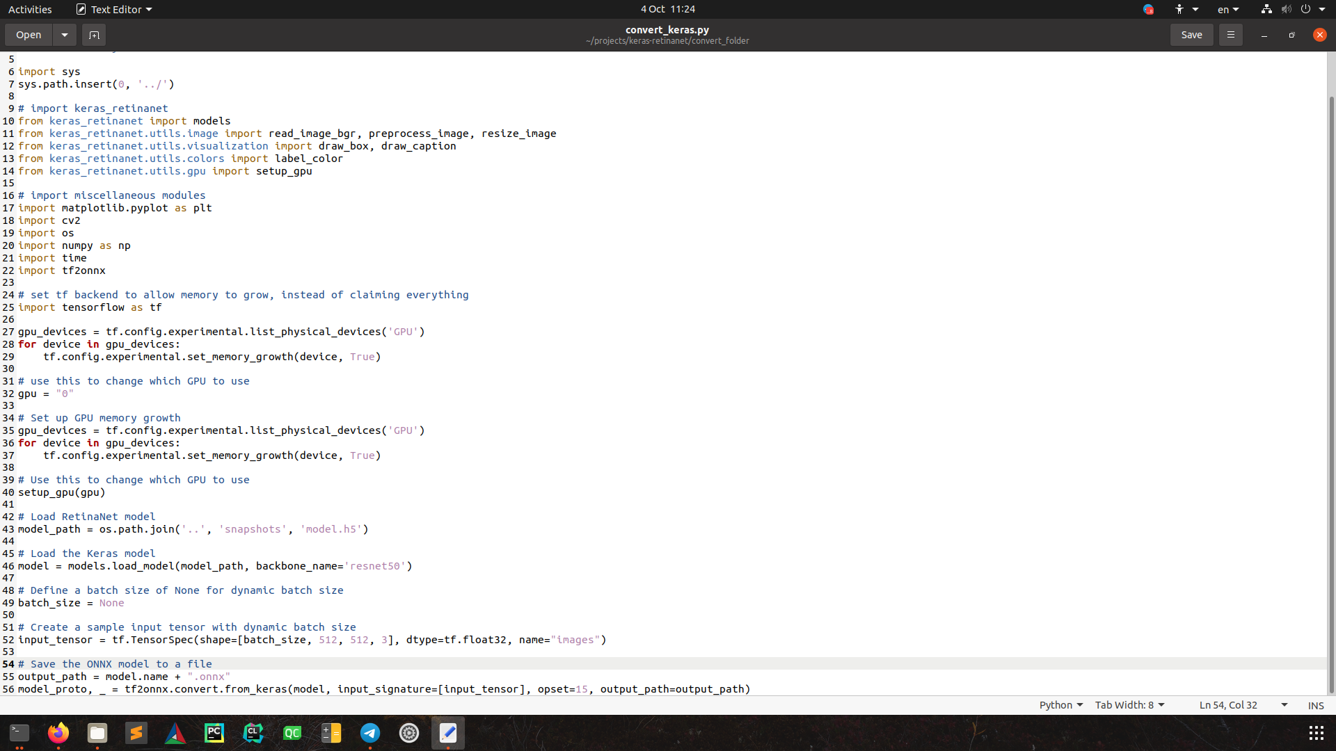

After training, I got the weights .h5. Next, I need to convert weights into ONNX model with dynamic batch_size.
Code for converting weights .h5 in ONNX-the model I took from here: keras2onnx

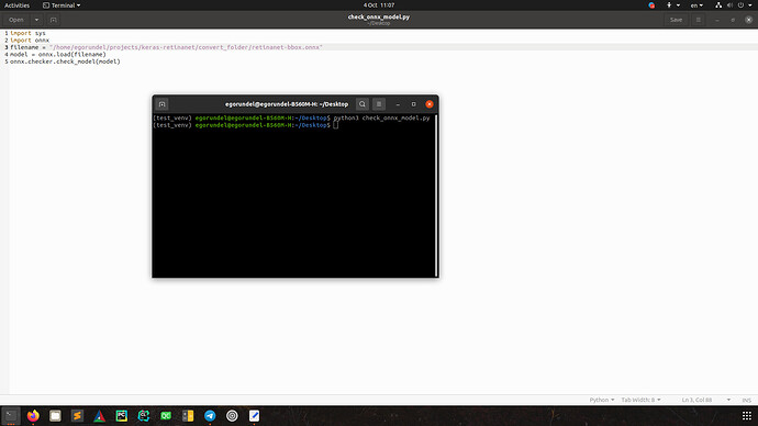

My ONNX-model is correct. I checked it with code: check_onnx_model.py
