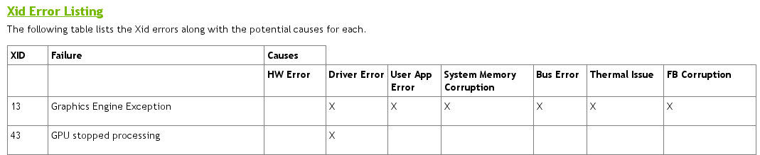

Error: Graphics SM Warp Exception on (GPC 1, TPC 0): Out Of Range Address (Xid 13/Xid 43)
Certain very intensive CUDA workflows make the driver soft crash (i.e. the corresponding CUDA application crashes but you may restart it):
dmesg/kernel log:
NVRM: Xid (PCI:0000:01:00): 13, Graphics SM Warp Exception on (GPC 1, TPC 0): Out Of Range Address
NVRM: Xid (PCI:0000:01:00): 13, Graphics Exception: ESR 0x50c648=0xe 0x50c650=0x20 0x50c644=0xd3eff2 0x50c64c=0x17f
NVRM: Xid (PCI:0000:01:00): 43, Ch 00000020, engmask 00000101
while the application reports this:
Unspecified launch failure
It would be nice if NVIDIA devs could look into this issue and resolve it. It affects non-overclocked Pascal and Maxwell v2 GPUs.
In my case I have NVIDIA drivers 375.20 and GTX 1060 6GB running at:
Core: 1922MHz
Memory: 7998MHz
Temperature: 53C
GPU usage: 99%
GPU power: 108W
all parameters are within the designated specs.
Edit: this is getting ridiculous: my GPU crashes every 5 minutes.

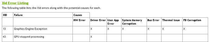

According to your Xid errors documentation, these two errors might indicate pretty much everything except a HW error.
This is reproducible with latest drivers. Sigh.
