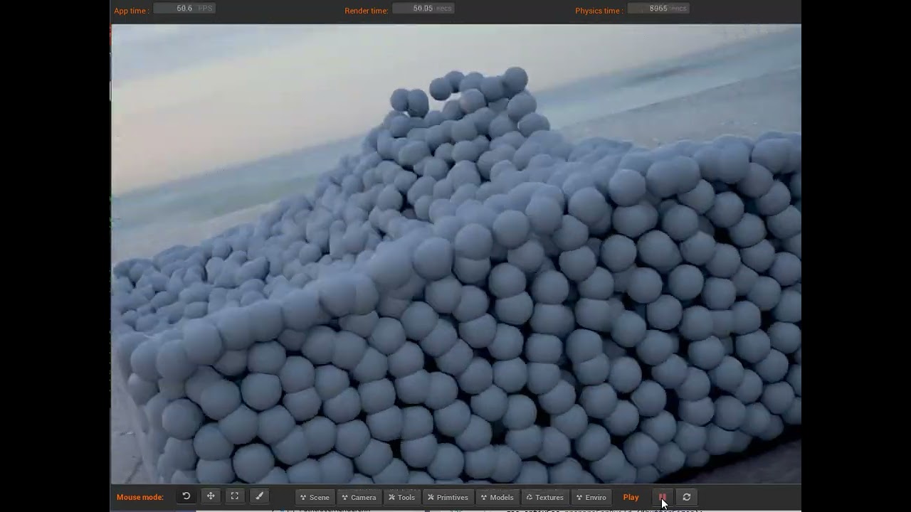

It’s true, as the docs say, that building an acceleration structure can be computationally costly. But you might be amazed, as I am, at how fast it actually happens in practice. This is one GAS with 16k spheres being rebuilt every tick. I’m still getting over 50 fps and that includes time spent in the denoiser on my antique GeForce RTX 2070 Super. :)
