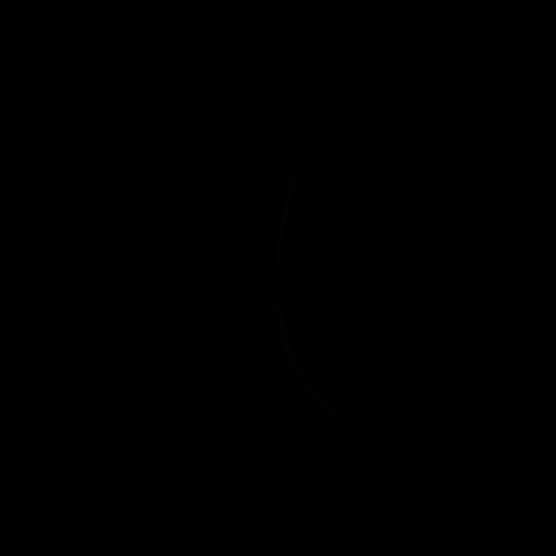

Still having the problem of nan result
More, as mention in Problem in training unet - #21 by Morganh
  1. Please convert the mask images to gray images. After checking the public dataset you mentioned, the pixel value is either 0 or 128. Please map 128 to 1.
  2. For binary segmentation, the label_id should be 0 and 1. BTW, if there are 4 classes , label_id should belong to 0-3
The image is created as Grayscale as follows:
Mat red (resized.rows, resized.cols, CV_8UC1);
Also converted all labels to be contiguous 0, 1, 2, 3, and 4:

data_class_config {
  target_classes {
    mapping_class: "foreground"
    label_id: 0
  target_classes {
    mapping_class: "Leaf"
    label_id: 1
  target_classes {
    mapping_class: "Stem"
    label_id: 2
And here is an example of a mask…
As mentioned above, for the case of grayscale, mapping is not required.
Yes, please refer to another user’s topic Training multi-class UNet does not converge - #32 by laurim
That example didn’t work for me.
