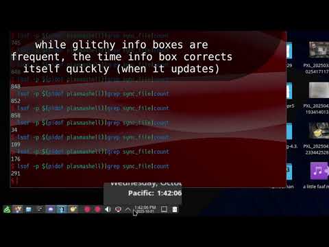

Fd leak with explicit sync and kde plasma
When the amount of entries gets to around 850 or so, thumbnails stop loading entirely and the taskbar/files on my desktop stop responding completely.
I’ve uploaded a video demonstrating most of these behaviors. In this video, I cause KDE in Arch to crash in less than 3 minutes simply by rubbing my taskbar:
